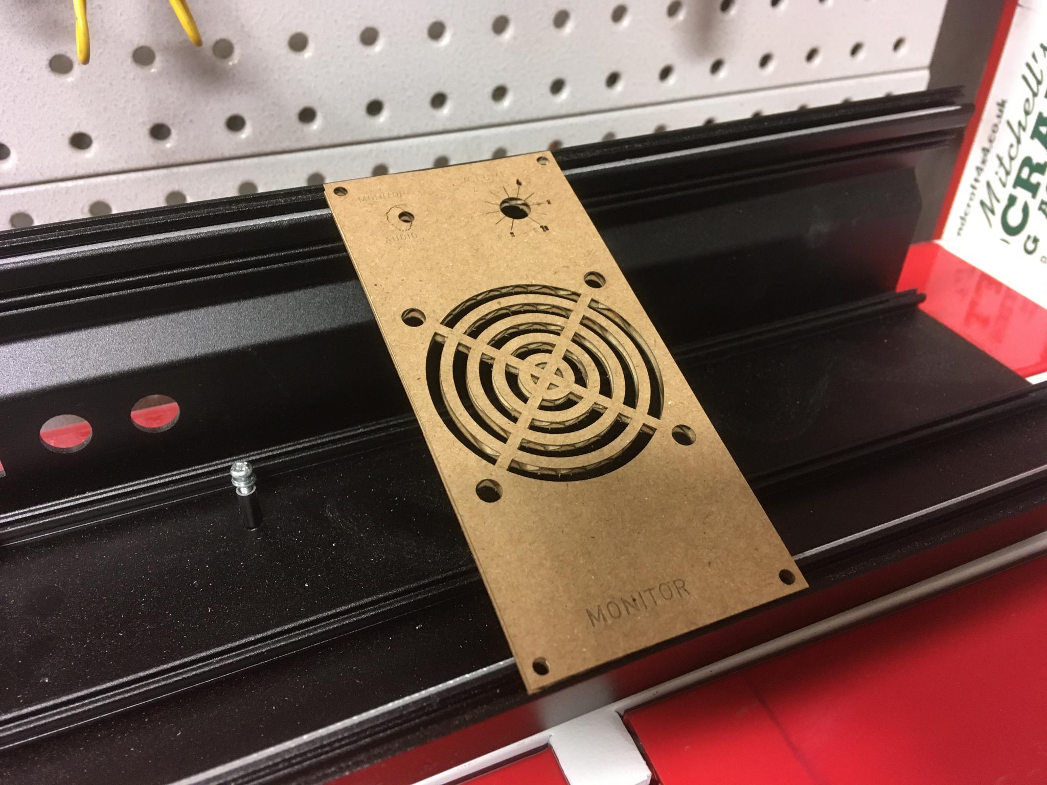

6/23/20 11:29 p.m.
Had some fun tonight and learned some things. Those two are often related.
First, my bed is bigger than I thought. Dunno why I had 9x8.5" in my head, but it's over a foot in one direction. Right after I picked up a bunch of 9x8.5 stock, too. I'm still learning just where the limits are - I actually bumped into them a couple of times tonight.
First I did some playing with 1/8" hardboard. This stuff is under $9 at Home Depot for a full 4x8 sheet and has a decent finish on one side, so it's great for experimentation. Turns out it cuts more like acrylic than thin plywood, which is probably because it's basically just sawdust in glue. These are test cuts to find the speed and power needed.
Then time to build a prototype.
Not bad. I think there's some slight variation in thickness of the material because it's almost but not quite a perfect cut. Either that or the laser power is dropping off on long cuts. Still, it'll do the job nicely.
I also played with transluscent acrylic. You want to use cast acrylic for this, it cuts better than extruded. I picked this up locally - I can order from Tap Plastic, but it's faster and less expensive to get it here in town. Assuming they have the color you want. This is a blue. It takes a little more to cut than the black I was playing with earlier.
What are you looking at? Quilting rulers. Quilters take these patterns and layer them and do things with them and make amazing shapes. And the rulers are goofy expensive. I don't know why, but this is half of a set that costs about $60-70. So here's part of my justification for owning this thing. It's cutting another one while I take the picture.
Of course, I could cut the fabric directly...
Things I learned - my air assist hose is out of the way almost all the time, but it did catch and drag the material once. There's a solution for that, so I'll add it later. I'm also still finding the edges of my bed. Ideally, I should have some sort of fence to mark the edge of it so I can hit the origin every time. Right now, I have a piece of tape with a little pinhole marking 0,0 and then I align the edges with the gantry. But that's a bit prone to error. The bed's also quite low - I have to lift stuff up about 17mm to get it into focus. I could either change the lens to one with a longer focal point or lift the bed. I can't see myself trying to cut something 34mm thick, although I suppose I could be trying to engrave the top of something 17mm thick.
Also, I really need to put the exhaust fan outside. After cutting two copies of that hardboard control panel, the shop was getting pretty smokey.
