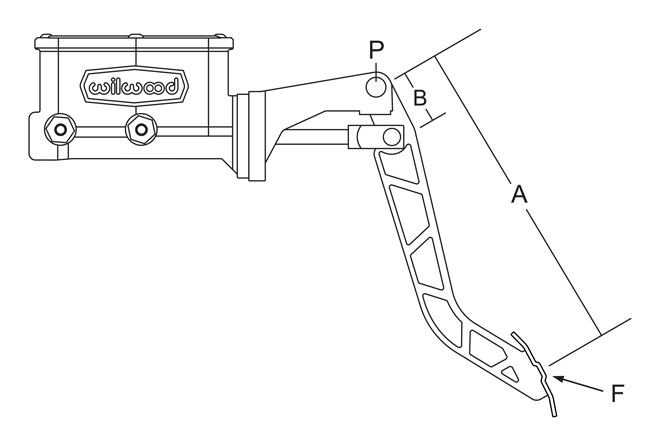

I have 1" also. I might get a pair of 7/8" to have ready for a swap. I'd like to see if pads make any difference first.
I just measured everything according to Willwood's instructions below. So my pedal ratio is 5.25:1 and travel is currently about 2.5" from rest to accidental poot. There is room for, conservatively, 3.5" more travel.
Measurement A = 10.5"
Measurement B = 2.00"
Pedal Ratio = A divided by B which in this case would be a 5:25 ratio.
pedal ratio

So you have the hanging pedals like me.  I'm exceedingly happy with 7/8" left foot braking.
For pad compound I'm using Wilwood polymatrix A.  The Wilwood rep said they were "too much", but the two other compounds I tried were horrible.  Im very happy with the A's
