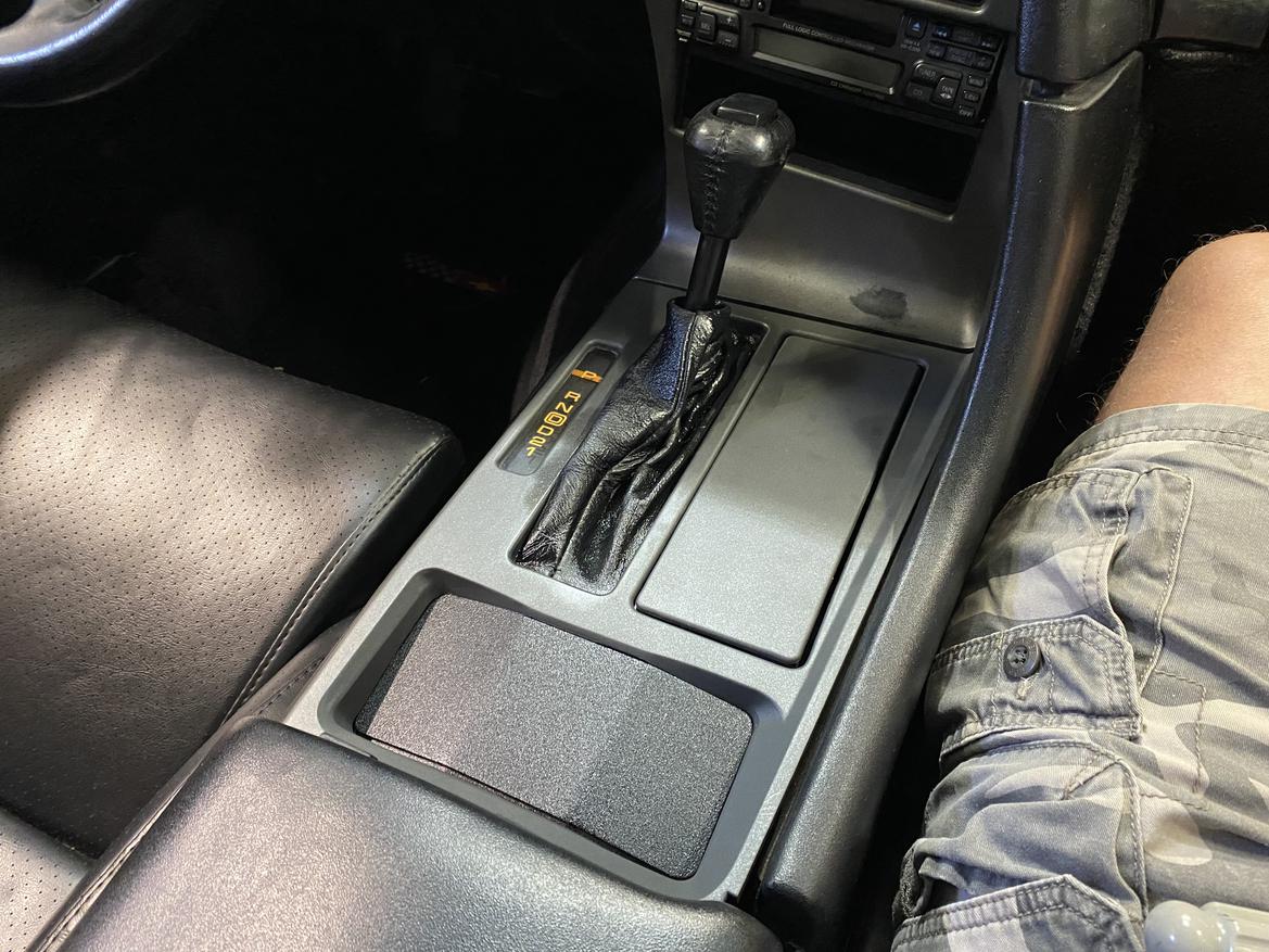

I spent some time today lowering the value of my car.
The power seat controls on the console are no longer hooked up since I have manual seats now. And the power suspension stuff doesn't seem to work. I am ordering new shocks to do away with the electrical adjustment doo-dad that the current shocks have.
I removed the console and completely deleted all of the wiring to these controls. Then I made a blank-off plate from some ABS plastic that I had laying around from a previous project. I sprayed it with textured paint.
I know this is all small progress but I do not like useless wiring or controls on my cars. Simpler is better on this turd

In reply to Cousin_Eddie (Forum Supporter) :
That came out looking great! Looks factory.

Is the blank off panel big enough for a cup holder? Could be a fun 3d printer project.
