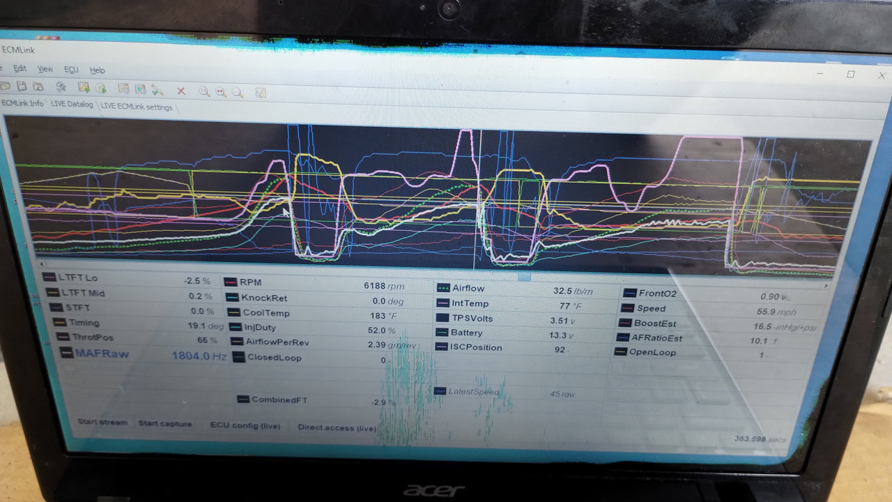

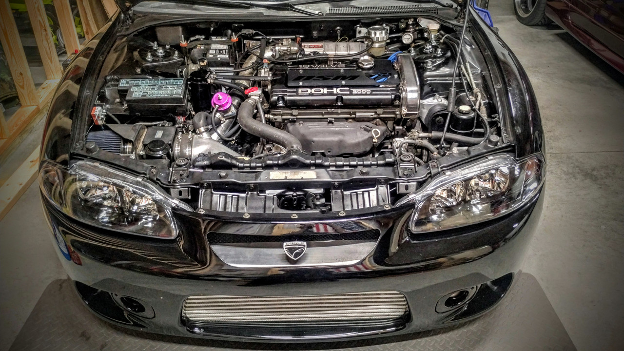

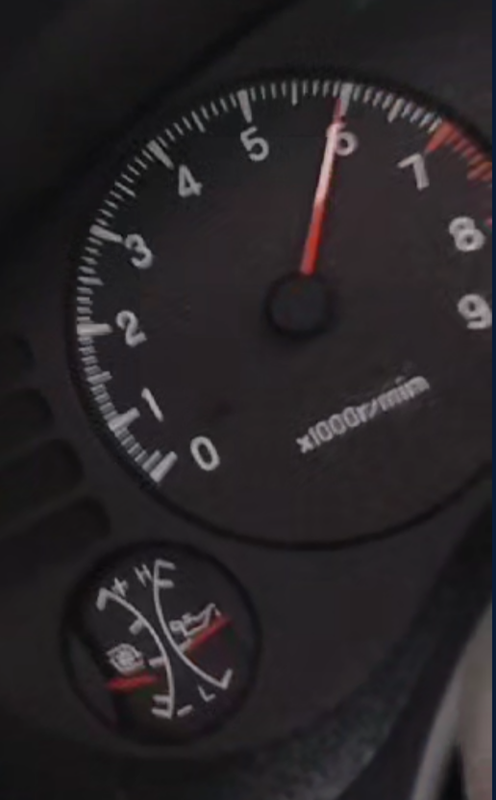

Car rips! Did some pulls, was 10.0 rich. I pulled out fuel, we mid 11's now, 32lbs min so we 300whp level with the 14b on like 22psi. Anxiety turned into smiles :)
The gas tank is pressurizing so im betting the stupid check valve line is pinched or something. Ya know, dsm things. ETA: found the pressurized vent line, wasnt venting to the front. Ill get this fixed upppp.
ETA: unhooked the pressure release valve line and it all came out so i have to clean out the line and the filter at the front. But it no longer keeps pressure in. Woooohoooo tank job is good to go.

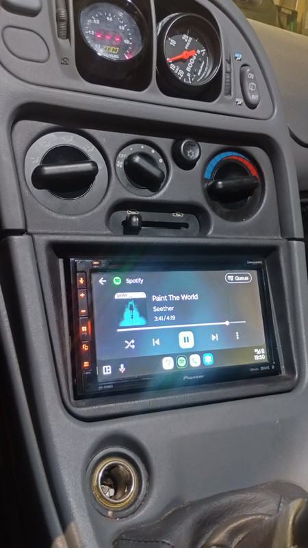

Waiting on a part for the Summit, i been cleaning up things and driving the talon a bit. Put my spare screen in, cleaned out the center console and cupholder and ashtray. It needed it.

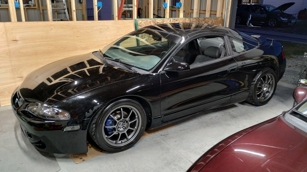

Got it aligned. Theres 2.3° on DS and 1.9° on the PS so its a lil off. Ill work on that. The steering wheel wasnt totally straight and it pulled to the right a bit so i am doing a tweak after finding the pass side was toed in a bit. Kinda annoyed but whatever, ill make the best if it. Back end feels way better tho. Cant fault the guy totally if he said it would pull from the camber issue.

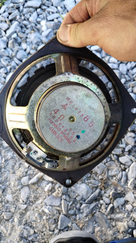

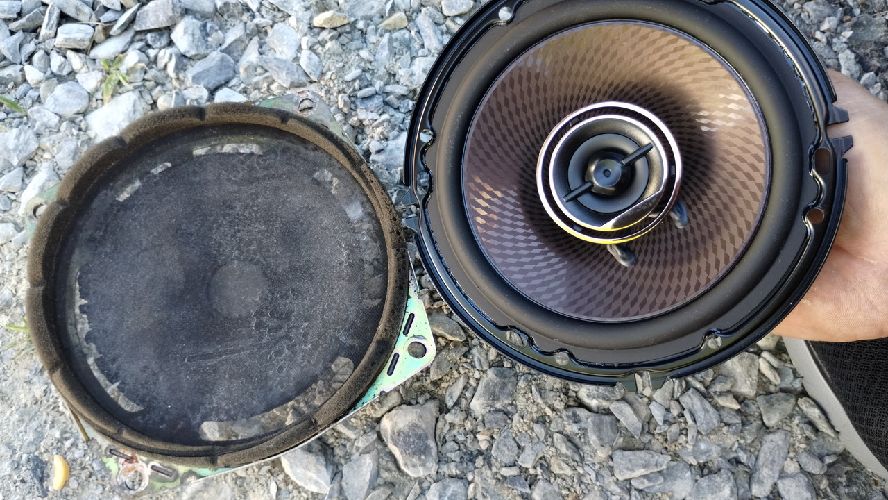

I got new speakers, old ones were um.....a bit worn out LOL.

I have an oil leak in the DSM spot. Above the oil filter area. Its somewhere. I blasted the area with brake clean and im watching it. Only a few drops on shut down.......it doesnt look like front main, and the belt is dry. I drove it for 40min, all backroads, getting into boost a lottttt. VC leak has subsided a lot. So now its just normal dsm leak things. Also, the car will be in Lancaster for C&C at the lexus dealer and urban werks....gor it ready just in time for  making some end of season shows, which was the goal!

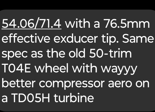

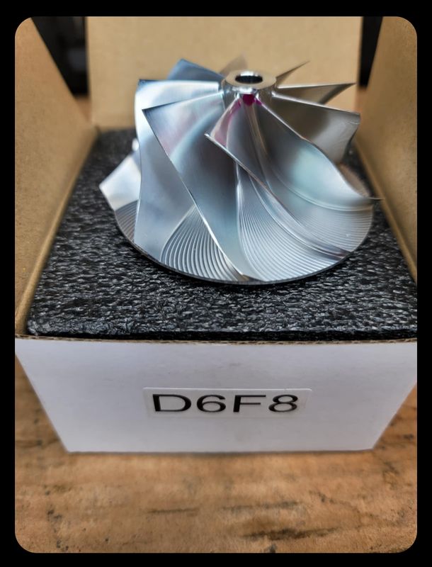

Also, the spare 16g turbo is all apart at Justins, and he finally got the wheel in......we making a billet FP Green style 20 or 25g....thing lol. Might be wild. Insaid id like to hit 500whp with it as a goal and then drive around at 400s level. That's usually the semi reliable area. I might hate it. I dunno. We gonna get weird and see how it goes.
GTX3071R spec with G25 blade aero

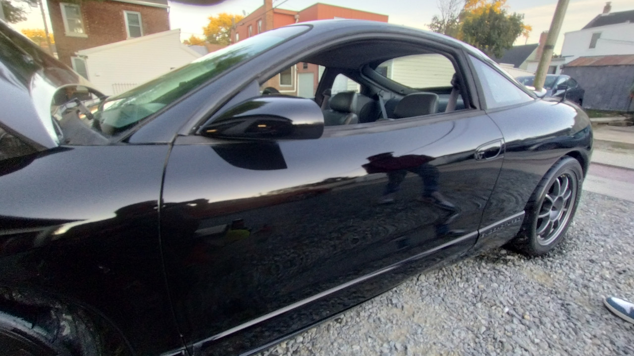

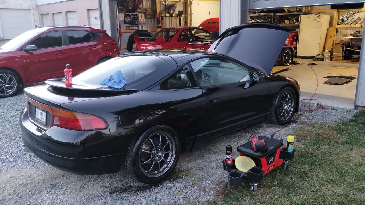

Wiped the car down, cleaned the wheels, and started buffing. Got the drivers side all shined up. It just keeps improving.
Car cruise ins on sunday, im ramping up the paint work again!

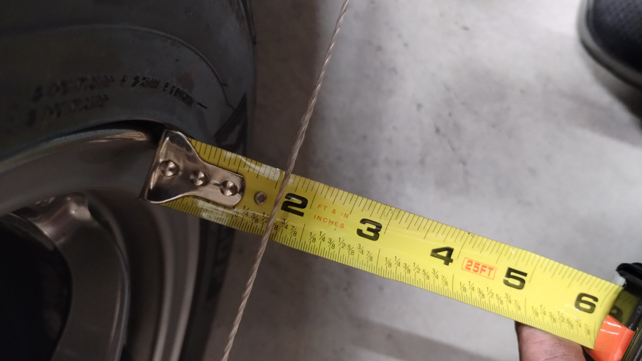

Spc adjustable upper ball joint is in and im having luck with that. Did string line toe adjust and its feeling much better

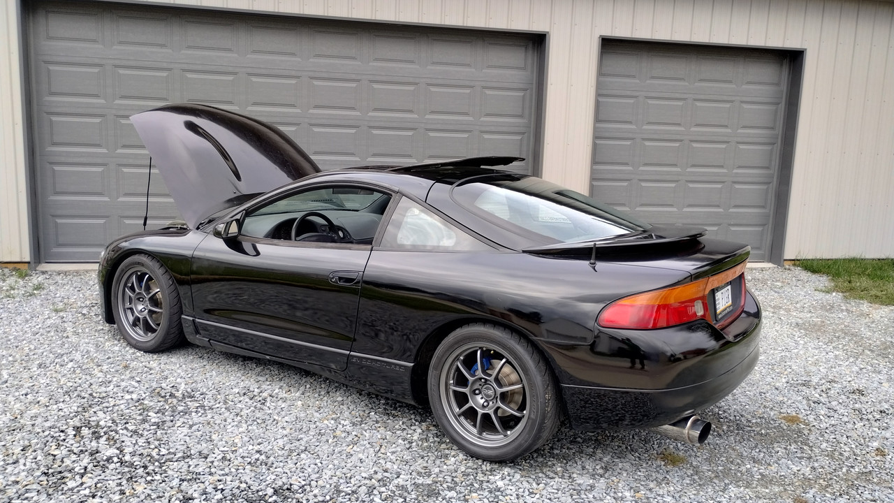

1 YEAR with the Talon yesterday :)
I got the greedy muffler put on. I have to move it in more but for not, no more dinker can. Sounds GReatttttt
Did sideskirt and door touch up / clean up work, took it out and took some pics :)
