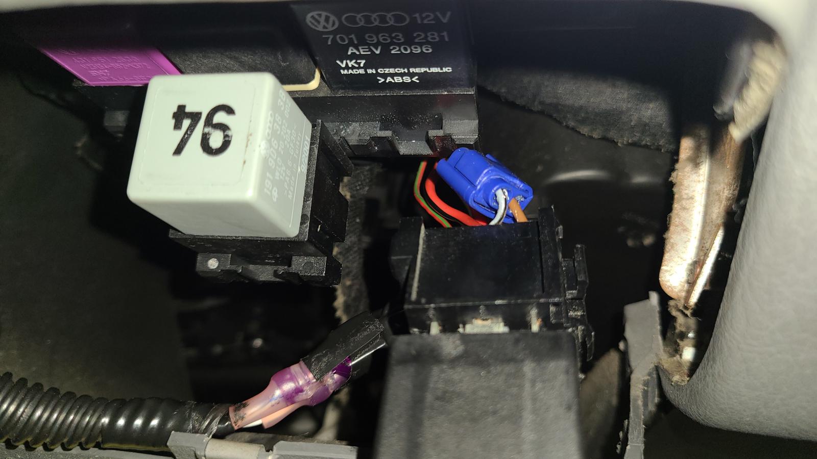

Back from vacation and dug into the electrical diagrams. The reverse lights are usually lit by the autotragic trans controller, but that's been fooled into thinking that the van's always in D. Coincidentally the reverse light relay is also the Park-Neutral starter safety relay so the hackage stays limited: run new wires from the manual trans reverse light switch up through the engine compartment harness, remove terminals 4 and 5 from the relay block and plug the switch wires in.
The starter interlock was a little harder but the same gent who makes the trans emulator pointed out that the trans controller pulls signal to ground when conditions are right, which is not when the TCM thinks it's in D. I clipped the wire to terminal 9 and scotchlok'd the stub to ground on terminal 7. Then folded the marked-up wiring diagram into the owner's manual, maybe it'll be helpful someday.

I couldn't convince the PNP relay to fire the starter, spent time today with wiring diagrams, a meter and a bunch of jumpers and failed to figure out why. So I modified the relay itself: the black wire runs from the ground side of the relay coil and bypasses the electronics. Marked it so that future me knows it shouldn't be replaced with a stock PNP relay. Starter turns nicely but will have to wait until the radiator is back in to fire it up.
The relay is marked 'mod' not 'moo', although maybe 'moo' would be better.
