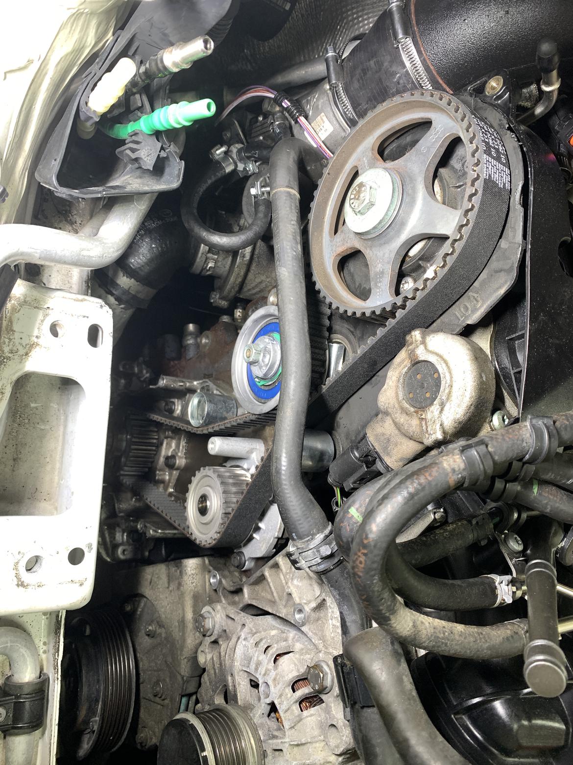

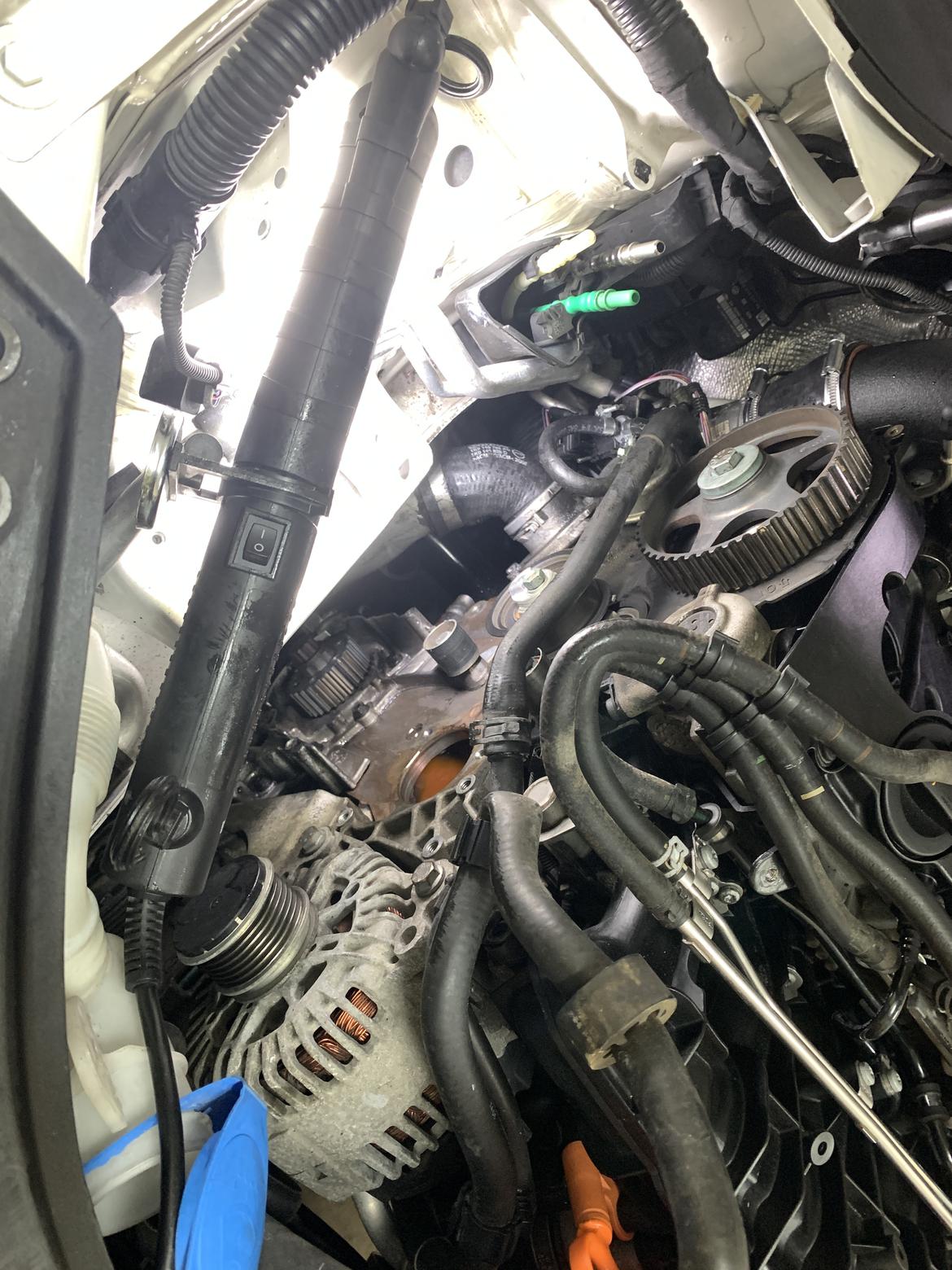

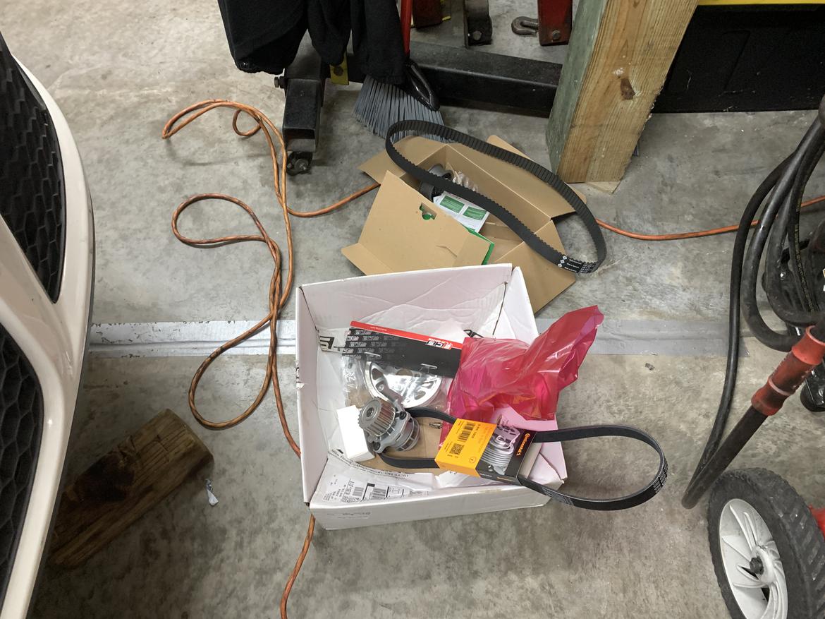

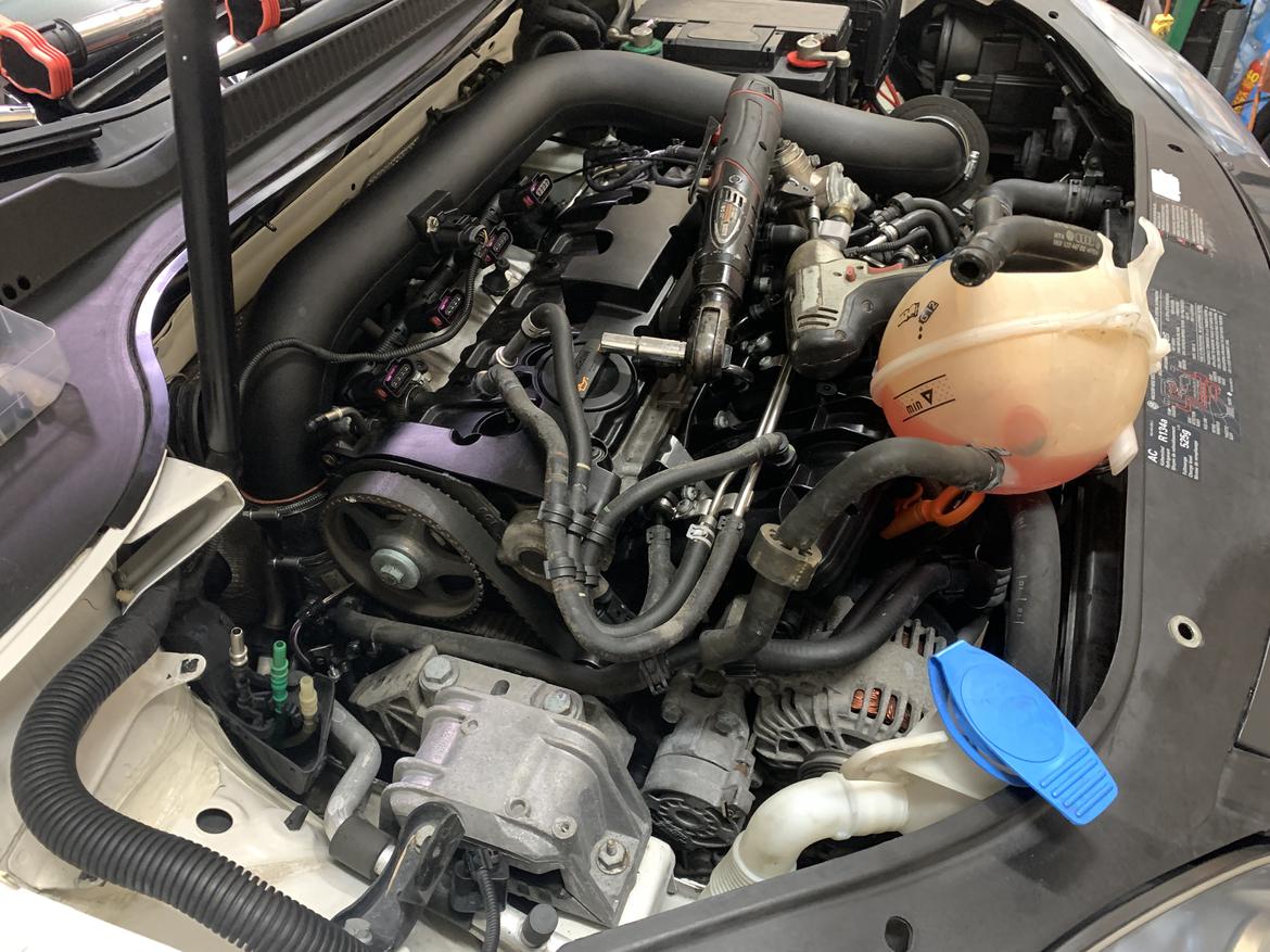

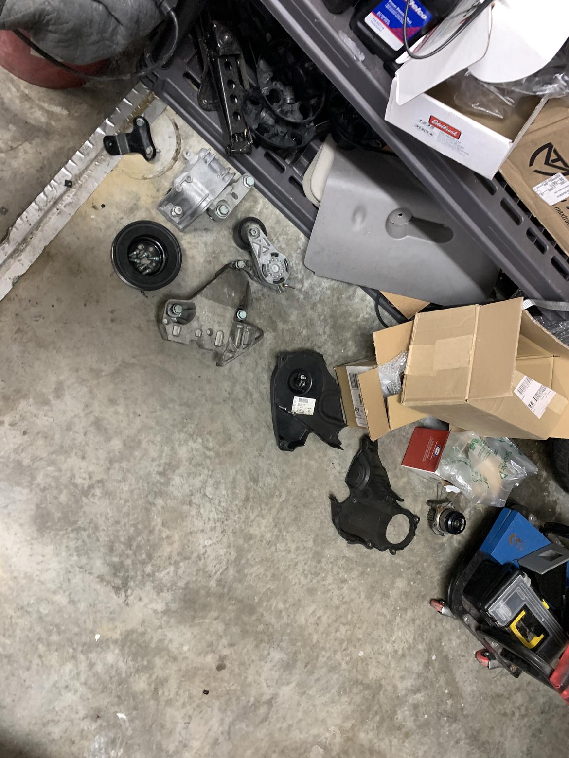

So my ocd is something that has in occasion saved my ass. This doesn't appear to be one of those.  But it will help me sleep better knowing it's done. So. I am doing the timing belt as well as water pump. While I'm in there I will slap on the ECS UDP. As well as an upgraded metal impeller water pump. Really wish the new HPFP came in as I could slap it on with the new pressure switch. I'm a big fan of doing these things. It gives me a fuzzy feeling to know it's done and I can drive wherever I want and at least that won't break!  Hopefully.

And done. Just need to reinstall all the goodies.
