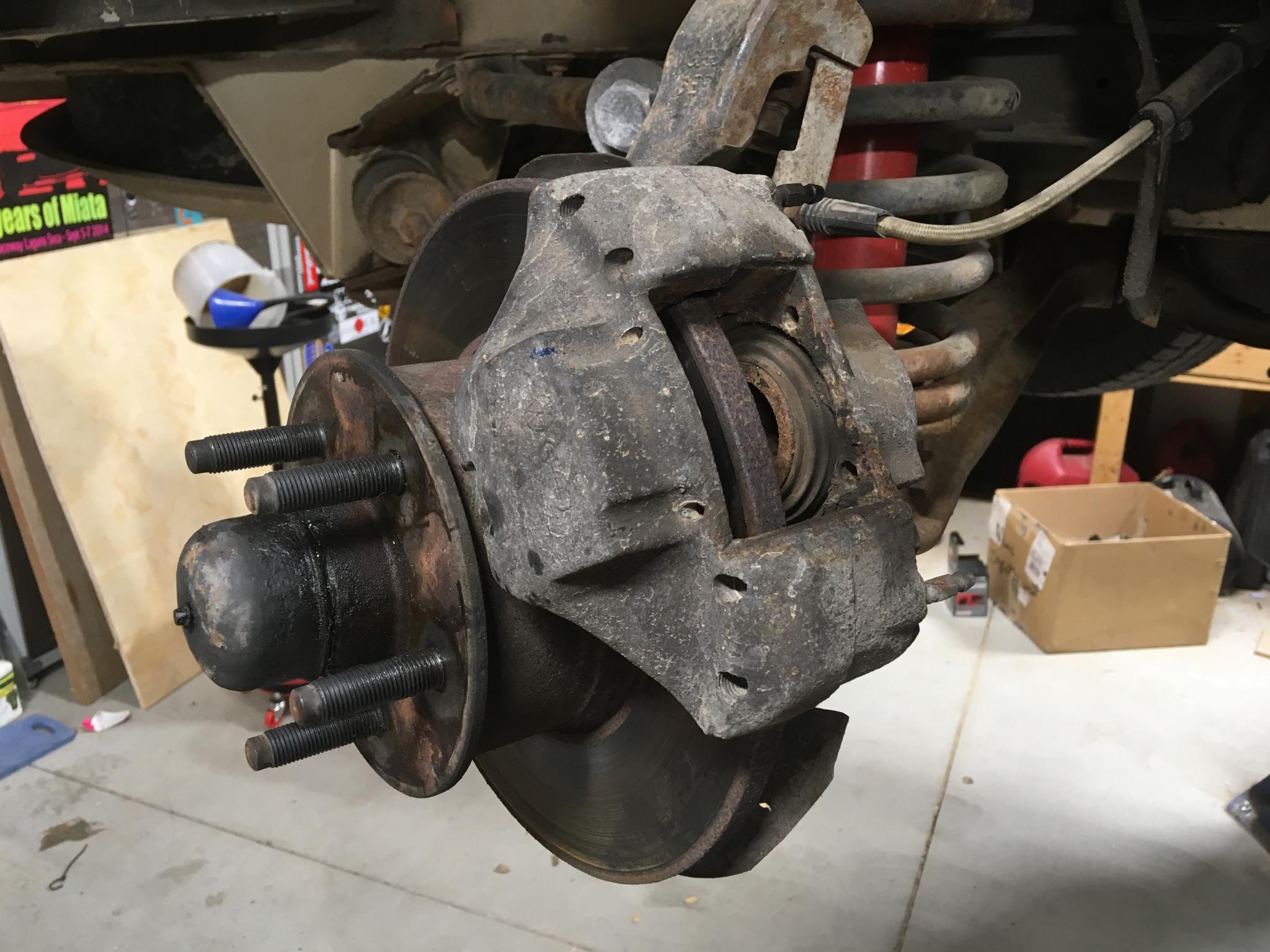

Here's stock, pads removed.

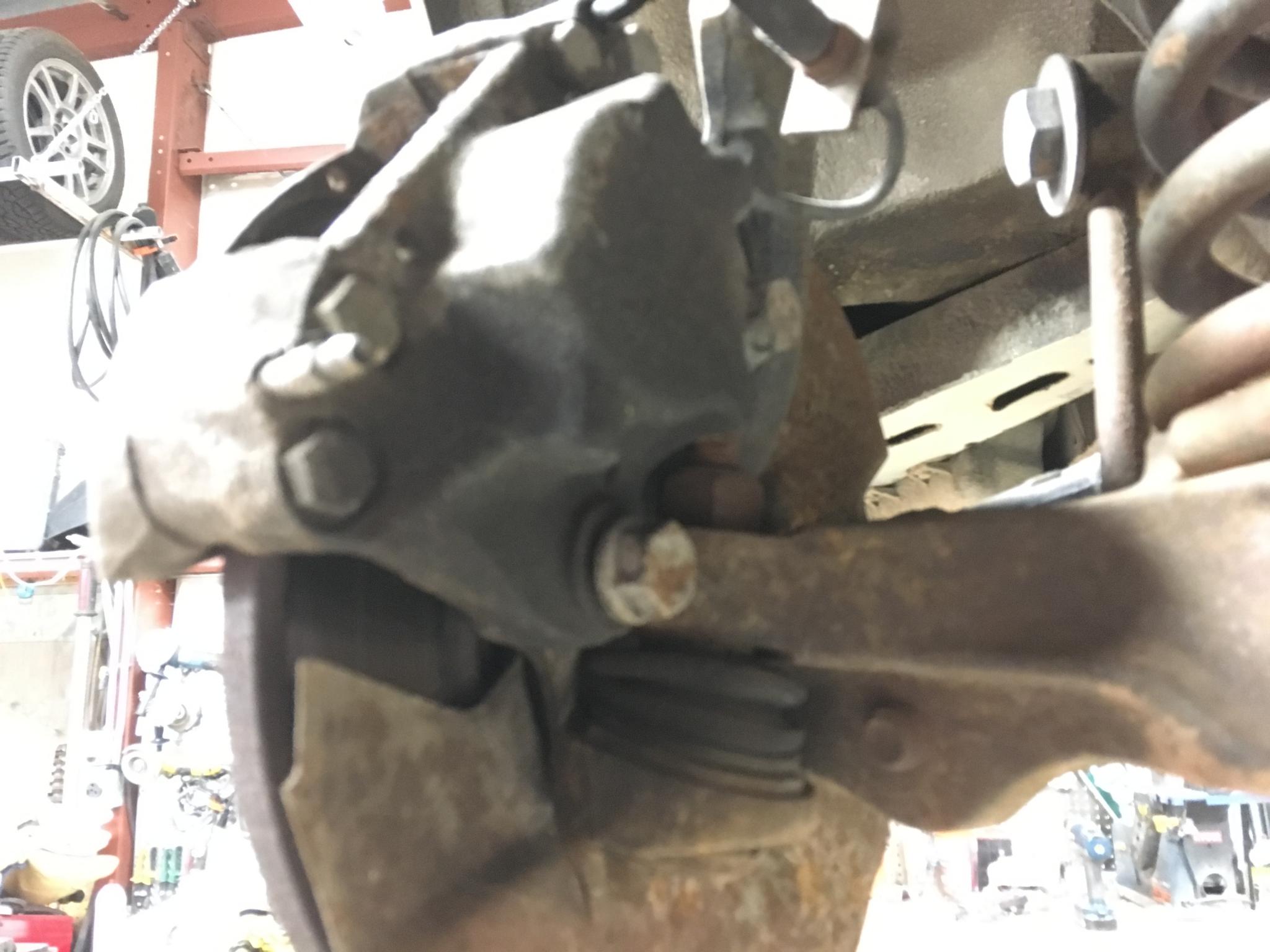

Bad picture of mounting. Interesting that this is a fixed caliper. I believe the later vans went to sliding calipers.
As best as I can tell, that's a pair of 2" pistons. That means 3.14 square inches of piston area. If I go to a four piston setup, I'm looking for 1.38" (3.00 square inches) or 1.50" (3.54). If I go with the smaller size, I can use an inexpensive Dynapro or even a Dynalite. But I'm tempted by the greater brake torque of the slightly bigger setup, and I can get that with a radial mount caliper that's got better weather sealing than the usual race calipers: the "Dynapro Dust Seal Radial Mount". Available to fit a 0.50" rotor (!) and in the size I want. It's not the cheapest option, but the calipers alone will be less money than a set of junkyard spindles and I only have to buy them once.
So I'll look into ordering some calipers tomorrow, then we'll see what I can mock up for a bracket. Wilwood unfortunately doesn't have drawings on their site for this particular radial mount design, but I'm pretty confident I can make it fit.
If I wanted to use Dynapros with a lug mount, I could be mocking that up tomorrow! And a lug mount would be easier to make a DIY bracket for. But I think I'll try the radial, I like the sizing a bit better.
Thoughts?
