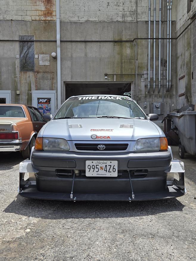

Hot off the press.
The new Arashi gt2554r is on and working well so far.  Still currently working on retuning the car for it.
Built a new air box for it, still not completely done hence the tape.
Also I revised the front aero for this season to try.
chiquito1228
chiquito1228 Reader
4/30/25 7:01 p.m.
That aero looks so nice
