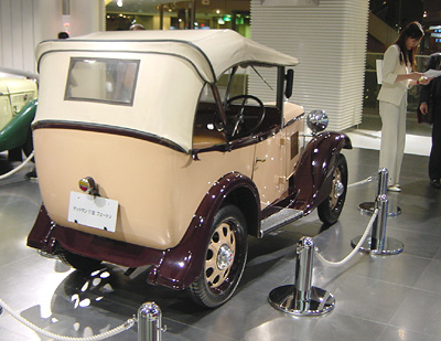

Yeah, the sides will be open. There's a picture of a ford phaeton at the bottom of the first page of this thread that shows roughly what I'm shooting for. I want to paint it tan and brown, though, so it is the same color scheme as the oldest datsun still in existence; i.e. the one from the Nissan Heritage Collection in Zama, Japan.
Anyway, open sides, a hood that will lift off. With that in mind, fake hinge, or no?
