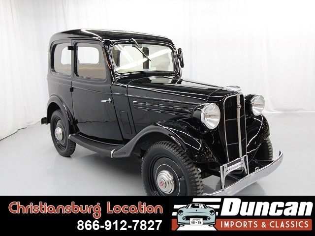

johndej said:
Very nice build.... saw this today and made me think of it.
https://www.duncanimports.com/used/Datsun/1937-Datsun-Type+17-5292d3690a0e08bb394b00e012635bac.htm
Hope to see some updates as it looks like a blast.
He turned down $45k earlier this year. I don't know how many people are looking for one, but I would have sold it

In reply to Steve_Jones :
It is a gorgeous car. Hard to find a buyer who wants to pony up big money for a 16 horsepower vehicle, however. Honestly, it deserves to be in a museum.  I would be talking to the North American branch of the Nissan heritage museum near Nashville.
There's one in the main branch of the museum collection over in Zama, Japan
https://www.nissan-global.com/EN/HERITAGE/datsun_17_sedan.html
