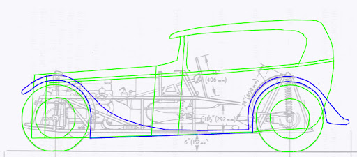

No major changes....I test fitted the new shaft. Since I don't have any new pictures that are worth posting, I'll give you something different: some doodles I came up with in 2007 after I first started toying with the idea of using a locost-derived chassis for this project. My early sketches looked a lot more like a lotus seven than a 1930s datsun. You can probably tell that I was reading the HAMB a lot at the time, too.
My original doodle of a possible body design
a cleaned-up version of it superimposed on a lotus seven chassis
Even though it is not the route I ended up going, I'm still fond of this idea. I hope one of you guys builds something like it so I can see one on the road.

Early 2007
JoeyM wrote:
By December 2007, the plan was still chopped/lowered/long, but it was starting to look like the original car.
By January of 2008, I had settled on the idea of near-stock, but scaled up in size so that it would not look odd with the longer-than-stock L24 engine from the donor.
