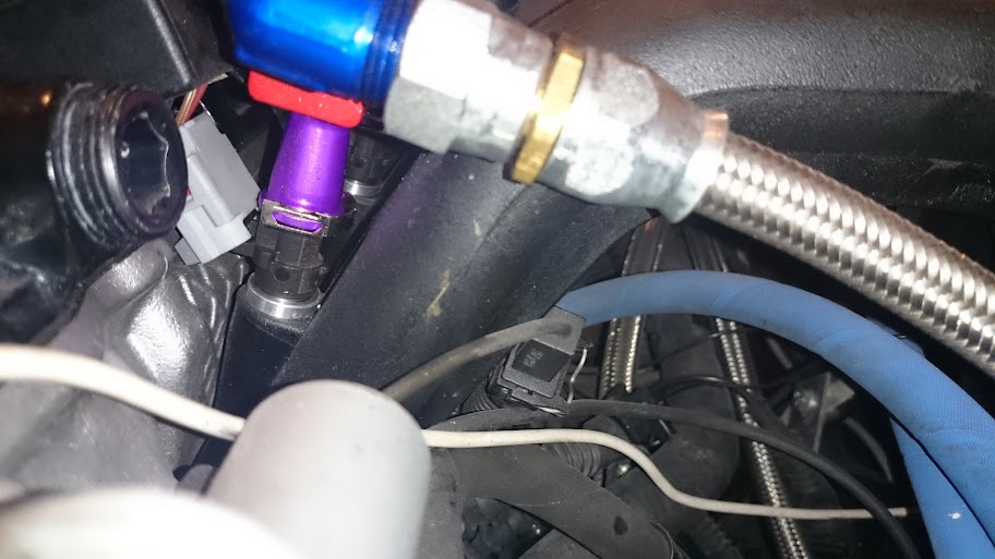

Anyway, over the weekend I drained the fuel and started converting to E85. Turned out one of my pickup pumps was dead and there is a problem with my fuel level idea - the sender ground pin grounds to the sender body so one sender is always like an open circuit. So it never reads lower than half tank. Will need a different solution. Probably averaging the signals separately instead of one resistance in series.
Also found out that the Aeromotive fuel regulator doesn't go to zero... I turned it all the way down, jammed a hose down the pump outlet line and fed it compressed air to flush the entire circuit out of the rail return. Just as I felt the hose inflate the thought flashed through my mind that maybe the regulator has a minimum press... and then it let loose all over, incl my face. Had to drop everything and run for some vigorous eye rinsing. I had goggles on for the rest of the night.
Almost done now though, new injectors in, new pump in. New lines as far as the firewall, quit for the day, will finish that tomorrow. Still need to get a new pickup pump and figure out a circuit for the fuel level. THEN IT'S DYNO TIME AND THEN TRACK TIME.
If you know someone interested in an as-new A1000 pump or 6 ID1000 injectors, let me know.
