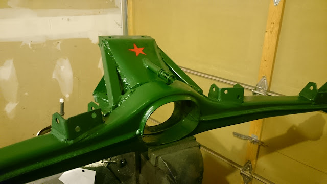

The Tank is done and installed. Too bad no one will see it. Next to button up the driveline and move on to the front end body work.

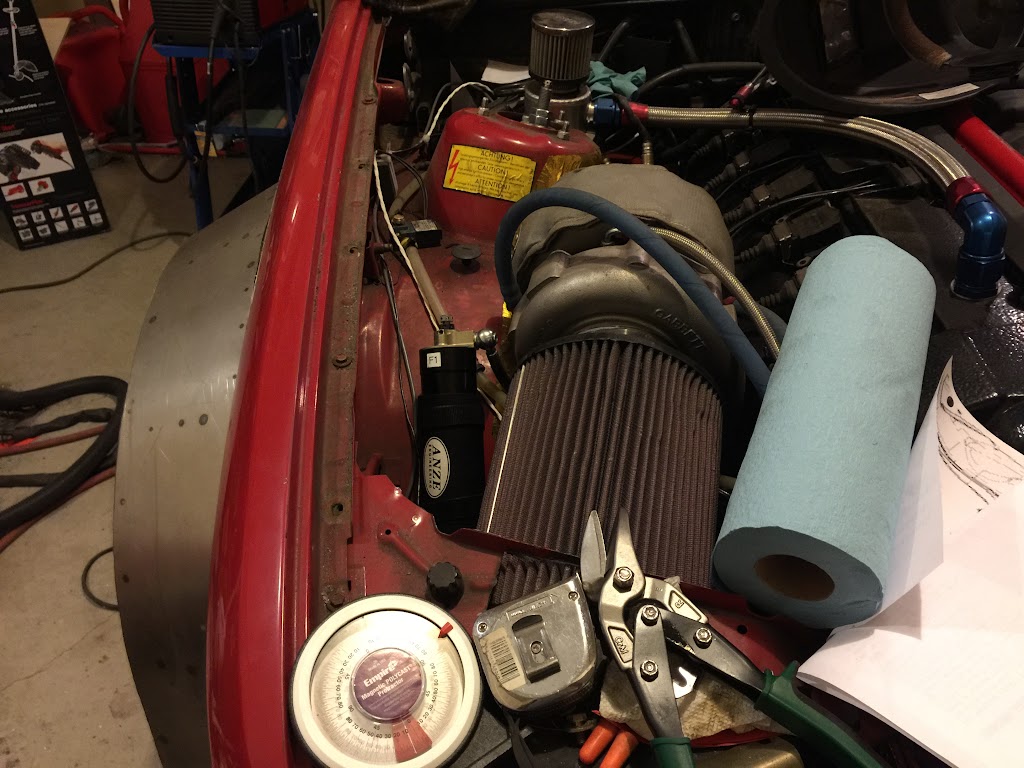

Getting there. Tucked the diving board and clearanced it for the IC and oil cooler - worked as I imagined, conceals them well. I think I have a pretty good idea for what I will do with the front - cut down the iS airdam to fit under the tucked bumper and blend it with the fender flare. Then there is the splitter...
My SLR arms are shipping tomorrow, they will place the wheels 1" further out so I made the flare with that in mind.

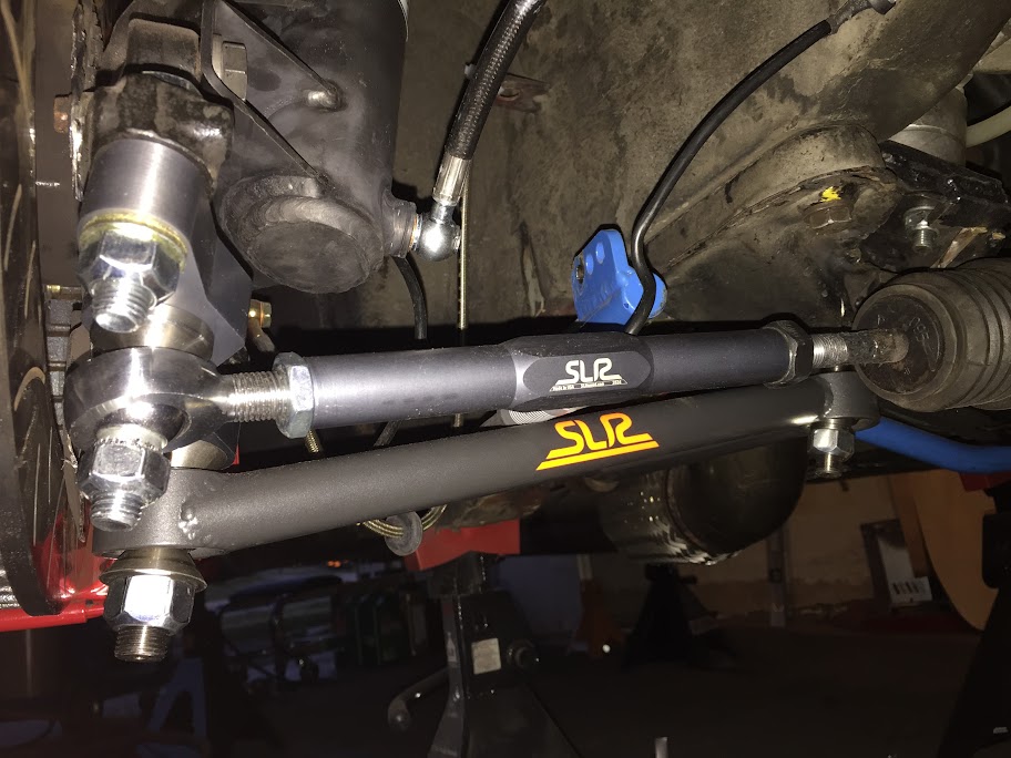

The SLR kit arrived, looks amazing! The quality is first class and it's beefy enough for a jumbo jet. Machining is excellent and the spacers are made out of 7075-T6. They're pretty f'en far from "just aluminum". Installing this weekend.

Wow, those control arms look like a nice setup.
The tank on the diff carrier is also hilarious.
Carry on!

Thanks! Too bad it will never be seen by anyone but I know it's there and thinking about it will make me laugh.

Installed the shocks along with the SLR suspension kit, everything went smoothly. Ran out of time to do the last rear corner but now that I know what I want to do with it, it'll be quick this weekend, along with the GC swaybar links which should be here today.

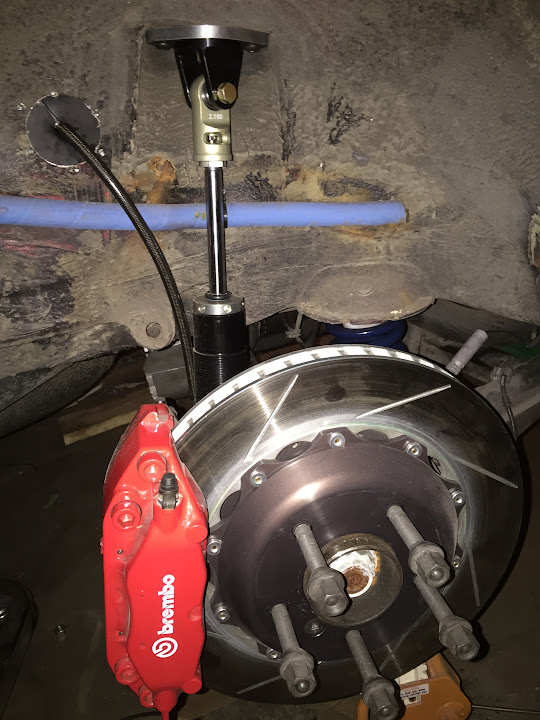

The fat Penskes interfered with the shock mount on the trailing arm. Swapped the bearings top to bottom and inverted the shocks. I like it better this way anyway, with the shock body and oil line stationary.
All canisters mounted and shocks installed!

The SLR kit looks awesome. I thought this was a track car? Wouldn't the increased steering angle from the bump spacer/tie rod relocation be more for drifting? Maybe you're more after the improved steering ratio.

It would definitely help drifters but I've always thought BMW steering is too slow, and I have one of the faster BMW racks, 95 M3. Granted much of it is probably due to my immobility being a big guy but I end up having to regrip the wheel for turn in for too many turns in BMWs compared to other cars like the FT86 twins. So the faster steering is definitely welcome, in addition to the fixed bump steer, roll center and wider track (and geeky sexiness).
