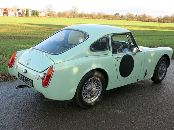

I saw a IG image of a MG fitted with an Ashley GT hardtop and though I like that but not entirely the way they did it.
I also really like the look of a early 911, but can't afford one anymore.  I wondered.. perhaps would a early 911 roof design language fix most of what I don't agree with on the Ashley GT?
Obviously this is quite Crude.  I didn't attempt to integrate the roof..  at all.. just scaled and stretched it to make it fit.  But, the Arched window opening, the C shape window ending level with the door really correct some of the "aftermarket top" look of the Ashley.  Also the smaller rear window opening that intersects with the extension of the bottom side window curvature really makes the hump look better.
Is it perfect.. no, but I think the general Idea of this roof shape would be really neat.  There are definitely some changes I would make to the front fender openings to speak a little better visually with the roof, and I won't simply copy a 911 roof but I will lean heavily on the style.  So I think that is likely the way I will go.  New seats, new Roll bar then build a had top.  Whenever I get around to it I will document it here.

That looks good!
AxeHealey
AxeHealey SuperDork
11/14/23 8:50 a.m.
I vote yes.

F-yes. It will be loud as hell inside but it will look great. I was about to say- damn- the windshield is pretty vertical for that eh? Forgetting the 911 windshield is pretty tall as well. It's a good look.
(Walks to the garage and speculates on his own ability to build similar)
