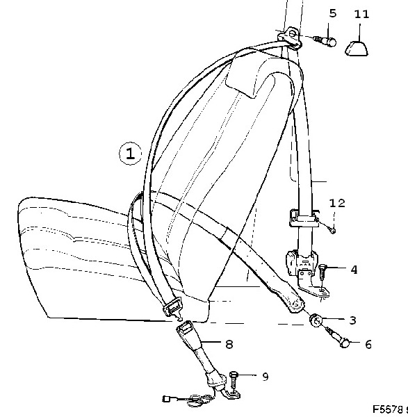

If you do remove that bit of insulation under the shifter rod and wiring loom for some cleanup (good idea, btw), be sure to reinstall it (or something else with some heat resistance). The cat is just under it, and I've seen firsthand what the cat can do to the wiring harness in that area if the heat shield starts to rust and that insulation is missing. It isn't pretty.
Since you have the interior mostly disassembled, I'd go ahead and remove the headliner backing board (it's easy at this point), and just scrape off all of the old nastiness and recover it. The job isn't particularly hard- just tedious. This will also expose all of the sunroof drain hoses and possibly help in troubleshooting the root of your water issues.
I've only done the seat belt conversion on one car and I wasn't satisfied with the results (we used belts from the wrong car), but I do remember referring to this FAQ from SaabNet: http://www.saabnet.com/tsn/faq/seatbelts/
Here's a pic of the proper mounting, lifted directly from the EPC:

Thanks Powar (Is your name Steve, i can't remember?) What didn't you like about your seatbelt conversion? As posted up thread I was thinking of using new aftermarket 3 point belts. If this is too much of a hassel, it may be the push I need to add the roll bar and harnesses instead.
Powar
Powar Dork
3/4/13 1:50 p.m.
Adrian_Thompson wrote: Thanks Powar (Is your name Steve, i can't remember?) What didn't you like about your seatbelt conversion? As posted up thread I was thinking of using new aftermarket 3 point belts. If this is too much of a hassel, it may be the push I need to add the roll bar and harnesses instead.
Tim.
I'd use the manual belts from an pre-'89 car. This way, you can use the factory attachment points. Don't forget to get the rear side panels from the same car. When we did the conversion on an '88 SPG, we used the manual belts from my girlfriend's '93 that we had just stripped. They mounted slightly differently, and we had to mount them at an angle that caused the belt to bind oddly, and not really want to retract. A quick search on SaabNetLinkCentral would probably yield the best recommendation of what car to pull them from.
