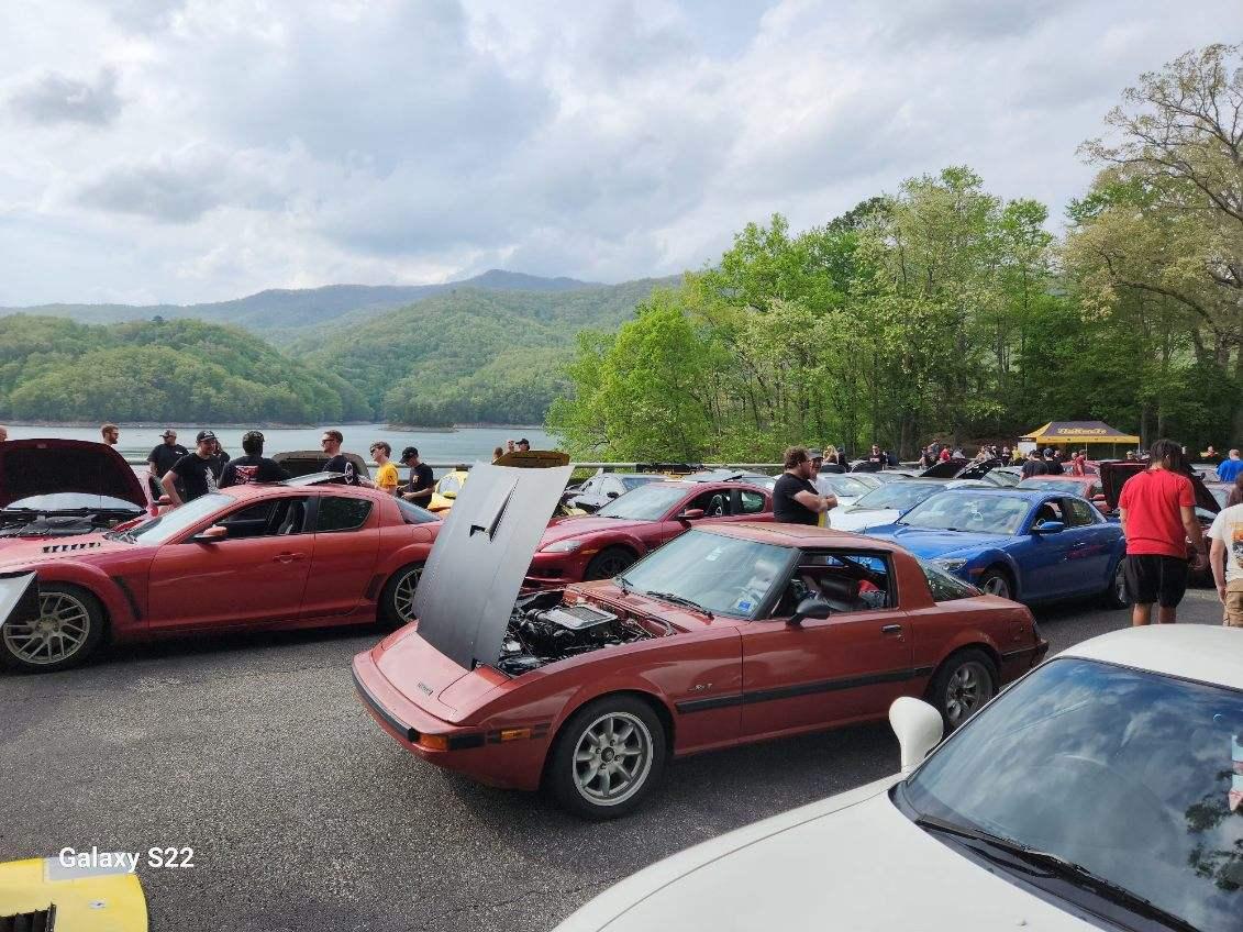

4/26/25 8:57 a.m.
Currently at my 4th Deals Gap Rotary Rally. Big turnout this year,  around 300 cars.
More to follow, but a couple of pics.
