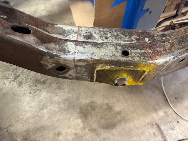

And I screwed up the body mounts.  I should have re-read all the measurements I took.  Measurements were done with the chassis 11.5" off the ground.  The chassis is currently 11" off the ground, so I welded them up 1/2" too high.  Something seemed a little off yesterday, but I was in a rush.  Have to decide whether I'm cutting them back off, going with the reduced ride height decrease (unlikely, since 3" was already a compromise), or doing something different like shaving the height off the body mount bushings/hockey pucks for the front mounts, while leaving the rest the same.
Edit:  A few quick checks with a hockey puck and an original bushing revealed some info:
  1. The metal part of the bushing is about 3/4" thick
  2. The rubber part is an indeterminate thickness due to it being mostly deteriorated.
  3. A hockey puck is 1" thick
  4. The hockey puck is small enough that it would likely pull right through the hole in the mount with a bit of force.
Think I am going to order a replacement cab mount (if I can get just one more cheaply than a full set) to take some measurements.  Maybe if I use the hockey pucks, I ditch the metal part of the bushing, and see about adding some bushing sleeves to the holes drilled in them.  If I do use them, though, I will need to add some material to the mounts to reduce the size of the hole in them, or it won't be safe.
I really don't want to have to cut and re-weld the mounts, as I am pretty certain I will lose enough material that I'll need to fab some short extension so they still set at the right distance from each other.
2nd Edit:  Looking at diagrams on the internet, it looks like my cab mounts have corroded, and the hole should be a smaller diameter anyway.   I have to do some thinking and figuring, I guess.  Also, body mount kits are incredibly expensive for a little bit of steel and rubber.

I think I'll cut the mounts off.  It will be a lot easier to reinforce them when they are off the car.  If I can find some oversized washers, I may tack them in place.  Otherwise, I'll cut something out of the steel I have.
The plan had been to use the original upper bushings, even in the shape they are in, and use the hockey pucks as the lower bushings, so I only need to budget for 6 instead of 12.  Hoping I can keep it that way.
