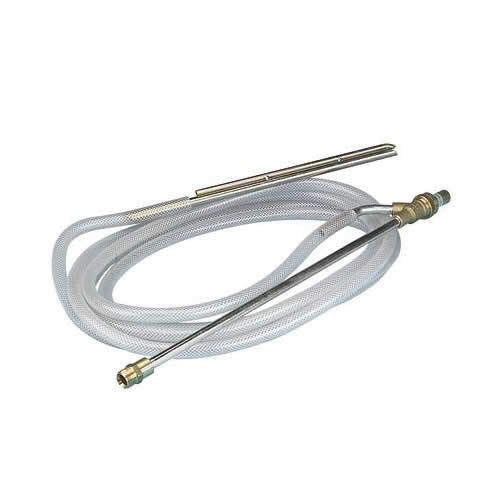

I have decided to strip the entire body, all the way down to the steel, for paint. Doing all this work and putting a E36 M3 paint job on it would be stupid. Sandblasting is out, soda blasting and media blasting is expensive just for the materials, so we are going to try water blasting.
With that in mind I picked up this today.
It's like sandblasting, but uses a pressure washer and water rather than a air compressor and air. It should eliminate the warping and the dust. I'll let you know how well it works.
Video of a guy blasting a truck.
