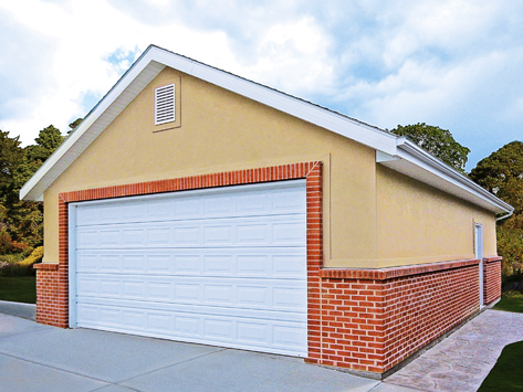

Curious about the whole tuffshed thing. I looked them up and the price seems pretty good for what you get.
A 24 x 30 garage installed, roofed and painted for 16k plus slab.
