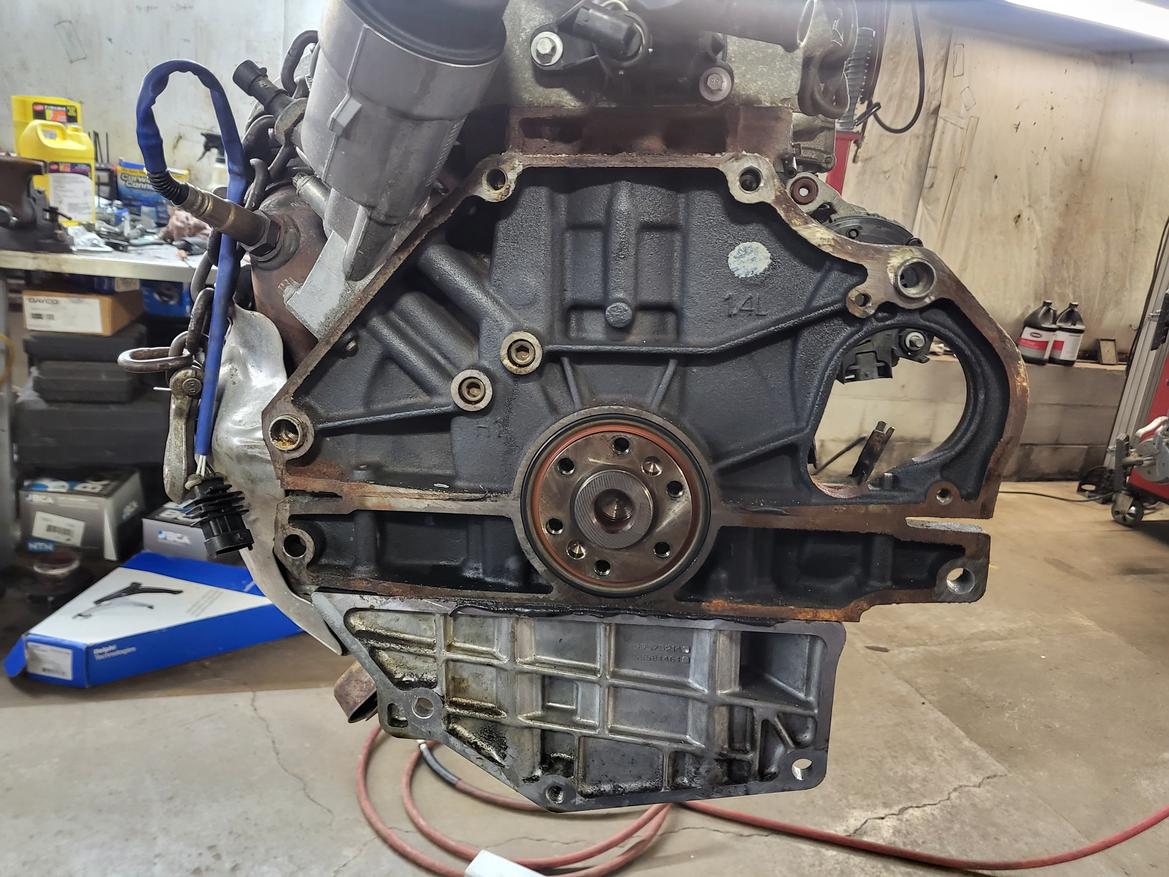

I don't recall the 1.4t having a bellhousing remotely like the Metric (aka 60º V6) bolt pattern.  Let me look up some photos...
I am not sure that there is a 5/6speed auto in the GM inventory that even has the 60 degree pattern.  Maaaaybe from a rear drive Caddy STS if that exists, since they used Northstars.  GM has a pretty good likelihood of using the same CAN messaging in everything so it might work.
The 3.6 bellhousing is way different, too.

I believe the dowels are in the same location, but tilted between this pattern and the 60 degree pattern.  But not any of the bolt holes except the dowels.
There are plenty of rwd 60 degree automatics (camaro, and s10 come to mind).
