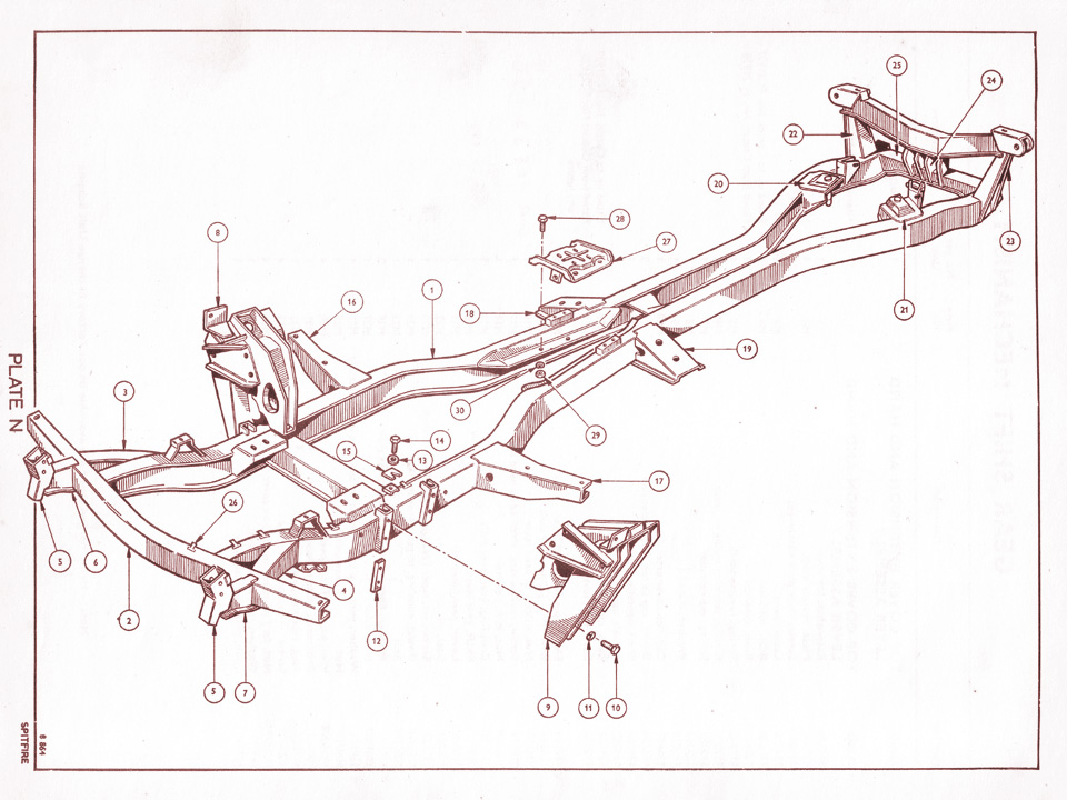

 Let the painting begin.
Ian F
Ian F UltimaDork
10/15/14 9:00 p.m.
Hmm... first time I'm noticing this... why was the frame cut? Wouldn't that add flex to the chassis?
93EXCivic
93EXCivic MegaDork
10/16/14 4:50 p.m.
Ian F wrote: Hmm... first time I'm noticing this... why was the frame cut? Wouldn't that add flex to the chassis?
I have absolutely no idea but I guess I haven't even looked at the frame of a stock one. Cause I didn't notice....
I really need to find a parts car...
Does that cross member just bolt on or is it welded? Victoria British sells the crossmember by it's self.

In reply to 93EXCivic:
Welded on my cars.
