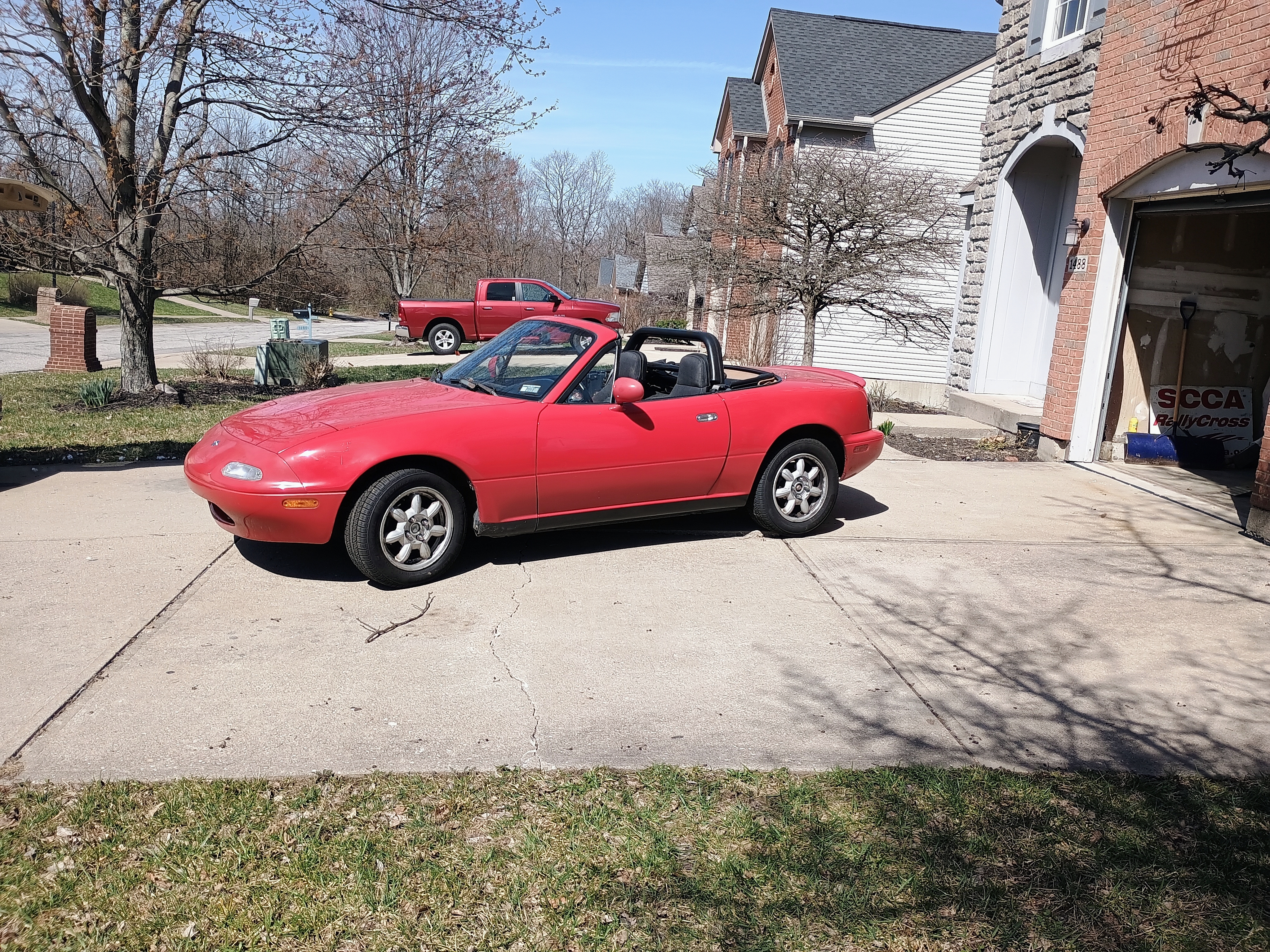

3/23/25 10:45 a.m.
I have never been so happy to break a bolt!
Back when I was replacing the drive shaft, one of the bolts that connected the flange of the cat exit to the flange of the tail pipe just froze.  It wouldn't tighten nor would it loosen.  Because it was just in there loose, I was left with an exhaust that didn't have a noticeable leak but there was an extremely annoying squeaking noise as the bolt rattled around a little against the metal.  On Friday, I put the car on the lift to take a look.
My plan of attack was to hit the bolt with the angle grinder to cut it off and then put a new bolt in place.  The PPF and the cat itself were positioned in such a way that I'm not sure how I would have been able to slice the bolt without also damaging one of both of them.  With a wrench on the nut and a breaker bar on the bolt, I went ahead and tried to give it a little lefty-loosey.  Best case scenario was that it would actually come off but worst case scenario is that it would snap the bolt.  Either way, I'd be able to get the bolt out of the flange.  It didn't take a whole lot before the bolt gave way.
So now I have that bolt replaced and the squeaking is no more.
I also took the opportunity to try to get a wrench on the downstream O2 sensor.  I've got a couple spark plug defoulers to put in there to try to silence the P0420 code that has the MIL illuminated, but when I was working on the car on the ground in the garage, I couldn't quite get it to turn.  Despite putting some heat onto it and giving it a little love tap with a hammer, there was still no budging the sensor.  The next thing I'm going to try will be to drop the back part of the exhaust back off the car again.  I suspect that if I can put it in a vice and get a good, solid fit of the O2 sensor socket on it while being able to get a more generous amount of heat applied, I should be able to crack it loose.
Other than that, the car is out of winter storage now and has been just wonderful to drive around.  I threw the hardtop on when I took it out on Friday since the temperatures had dropped a bit.  I know this is an unpopular opinion, but I think it's got a really neat feel when it's a little more closed in and I really like the look of the car with the hardtop on.  No pictures of it like that at the moment, though.  I need to give the hardtop a polish and wax to get it looking as nice as the rest of the car.   But this is how the car looked after nothing more than disconnecting the Battery Tender, putting some air in the tires, and pulling it out of the garage.  It's really neat that I can have a "project car" that I did absolutely nothing to over the winter and yet, when the salt has been washed away, I can just get in, fire it up, and go enjoy it straightaway.  I still have a list of things that I want to do to it, but not having done those things doesn't really result in any meaningful compromise of my enjoyment of the car.
