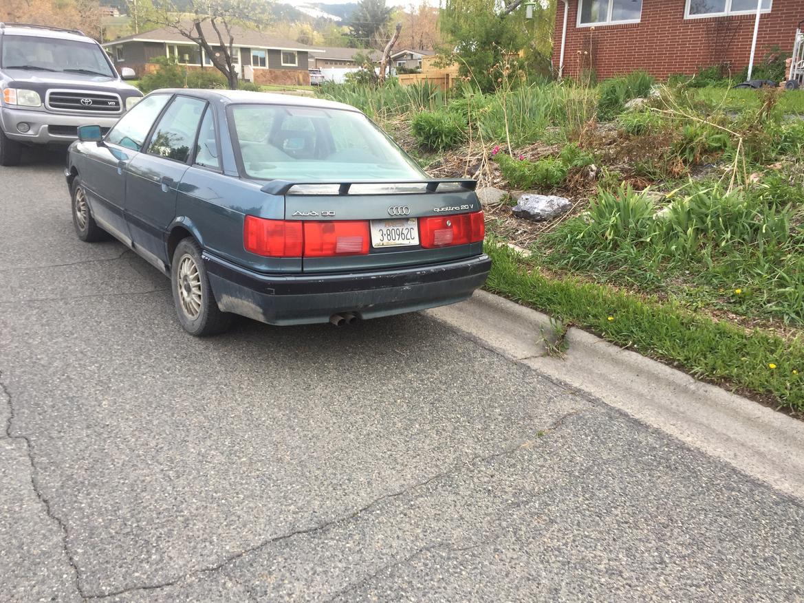

But, There is an Audi parked like a block and a half from my house that I have never seen move in the 4 years I've been here. Turns out, a bike shop customer and all-around nice guy that I have met and chatted with about my Fiat project, owns said Audi. He got it for free and is happy to pass it along for the same price. It has a key, a title and "ran when parked". I didn't even get to the 'free' part of this story with my wife before she knew the exact car I was talking about and expressed interest in it. So, I guess maybe there is some kind of reason to get it. There are a few issues (shocking) including some damage to the right front corner BUT: AWD, FREE, and Manual trans. Plus apparently 5cylinders and 20 valves. These are the pictures that I took in 2021 when I noticed that this cool old Audi was just apparently sitting there indefinitely.
It looks much the same now, but with 4 years less air in the tires.
Well, here is the start of the Build Thread while I don't have the car yet. The great thing is that it should be one of the easiest tows home that I have ever done. Unless, It actually makes the drive?

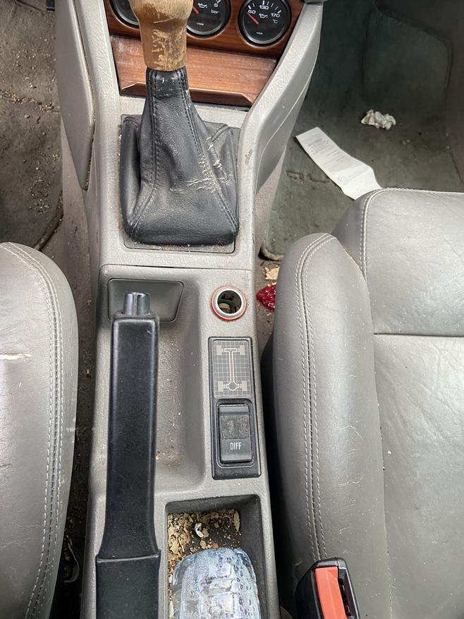

This is so cool to me. Diff lock.

Sunroof, it made bad sounds and I assisted it up. Diff lock button. Does not click or light up. Stereo didn't play or eject it's tape. Power locks, if I push down the drivers door lock there is some noise and nothing comes of it.

The diff lock may also be pneumatic. In my '85 4000s Quattro, a battery leak caused acid to drip on the diff-lock actuator under the car and ate through the plastic, letting all of the air out (the battery vent tube exited right over the diff lock actuator).
