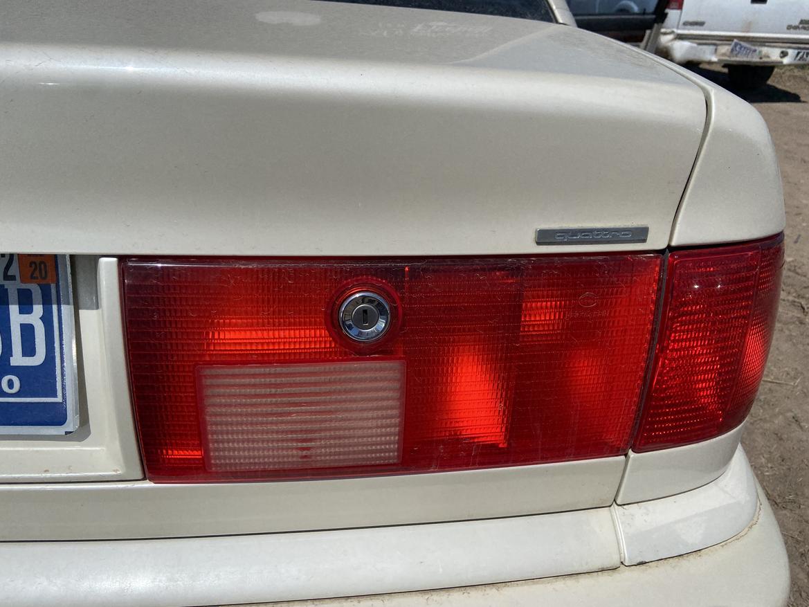

Anobody know if the light segment with the key cylinder in it will interchange with the 97?
That car has pneumatic locks and the steering wheel, controls, grab handles etc. all look very similar. This is mine:
and the Junkyard one:
Maybe the same piece?

No, the B3 is a different setup than the B3.  B3 stopped in 1991.  You can get a rear light from any b3 90 though.  I'll look, as I may have one haha.  If I don't, my buddy probably does.

Thanks! Right now my shopping list has a pass headlight and corner and that tail.
