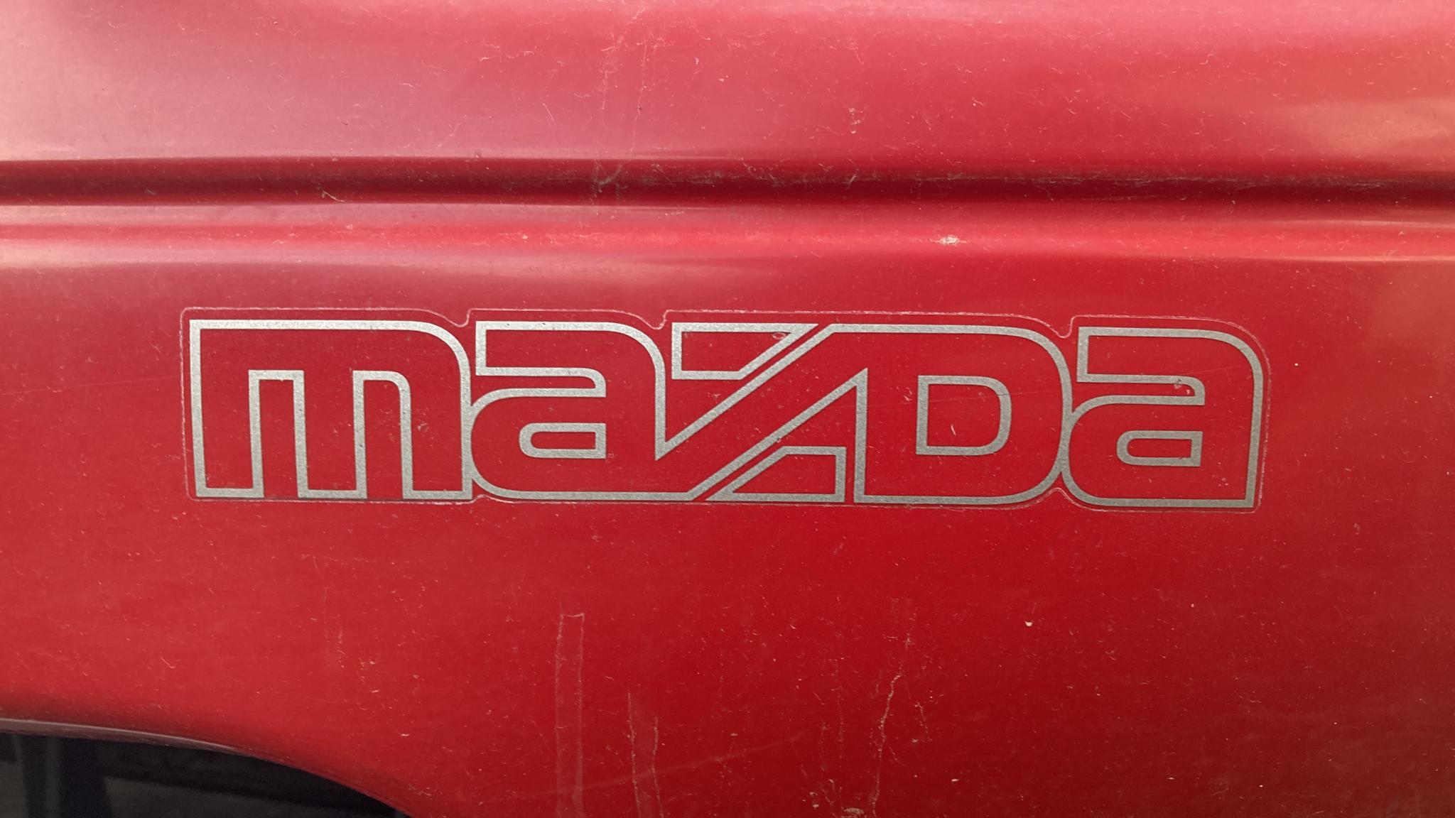

Printed like a waterslide decal, or something else?  Cause the antique outboard folk have people doing waterslide decals for old outboards.  If there is a market for something closer to original I could ask for a couple vendors to talk to?
Scopecreep
Scopecreep New Reader
12/4/22 12:59 a.m.
Agreed, they were a different type of sticker. The lettering was under a clear plastic material.
Here's what mine looked like before I did the vinyl outline sticker. Once I got the original sticker off (was initially a rectangle) I could use the outline left on the bumper to
line up the new one.
I suspect the new one will last for several years since it's not a daily driver and spends nights and weekends in the garage but isn't nearly as durable as the original.
12/4/22 1:03 a.m.
Mr_Asa said:
In reply to Keith Tanner :
Like just a printed sticker with a clear backing. Not rocket science to recreate, although it's beyond the scope of a hobby-level vinyl cutter. I could probably order a few hundred of identical stickers on Monday from the manufacturer that does the Flyin' Miata freebie stickers if I wanted to. But the market isn't huge, so leaving it to the Etsy hobbyists makes sense.

12/4/22 1:33 p.m.
This is on a supercharged 1990 Miata. I thought it is fitting for it.
12/4/22 6:29 p.m.
Here's an original in good shape on my first car. Yes, the one I bought 30 years ago.
