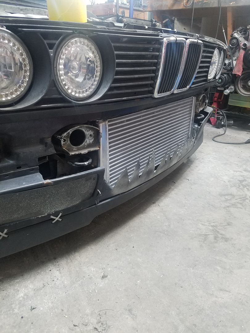

So, the entire plan for the e30truck was to make my girlfriend her forever car. She's in the haunt industry. As in, haunted houses and such. She's a costume director and as such attends haunt conventions (I didn't even know this was a thing, btw). She wanted something gnarly she go drive there and until I make her an e30 hearse, this will be it. Since her first car was given to her by her grandfather who she adored, I wanted to include a part of it in the e30. What's the best part about a swedish brick? Well, the turbo 5 cyl of course.

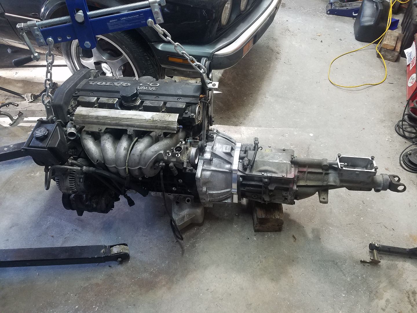

I picked up another e30 to swap the volvo motor into while she drove the truck since it would take awhile. Then I could transfer everything over to the truck chassis.
It wasn't pretty. Because it was basically free. And I never planned to keep it around, just use it as a test bench for the t5 swap. Conveniently, there's a Canadian that makes an adapter to bolt the Volvo motor, to a mustang t5 in a rwd configuration. Simple! Now it's a T5/T5 swap.

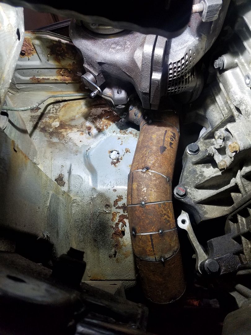

Everything on this build was scrap. Heck, the downpipe was made from some exhaust tubing I bought and then forgot about out in the backyard.
Yikes. But it works!

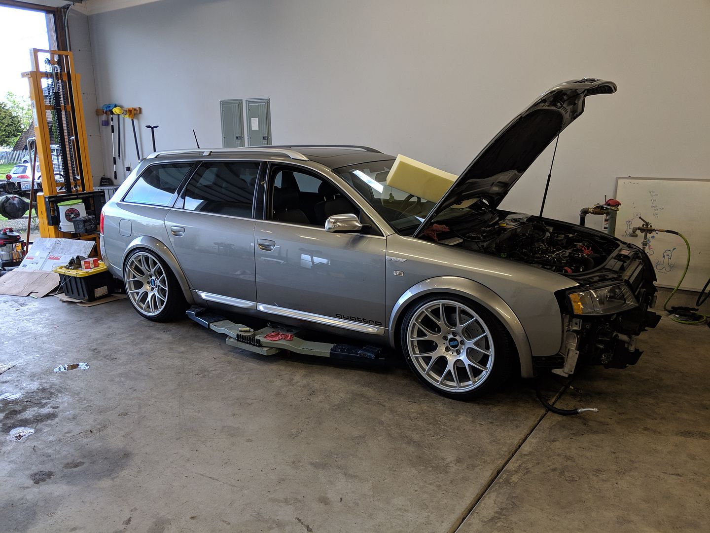

The problem, as many of you are aware I'm sure, is that once you get a lift friends show up and ask to borrow it. Immediately I convinced a coworker that automatics are trash vis-a-vis fun time driving. He's an audi guy, so he shows up with an allroad, a 6speed manual and two big aftermarket turbos.
This thing is a John Hammond type of build, spared no expense. 20x10 BBS wheels, Porsche brakes, coilovers, everything 034motorsports sells and then some. We dropped the engine, converted it to manual, swapped the diff and then he had me gut the exhaust. It has no cats and no mufflers. It's ungodly loud. But he loves it so whatever.

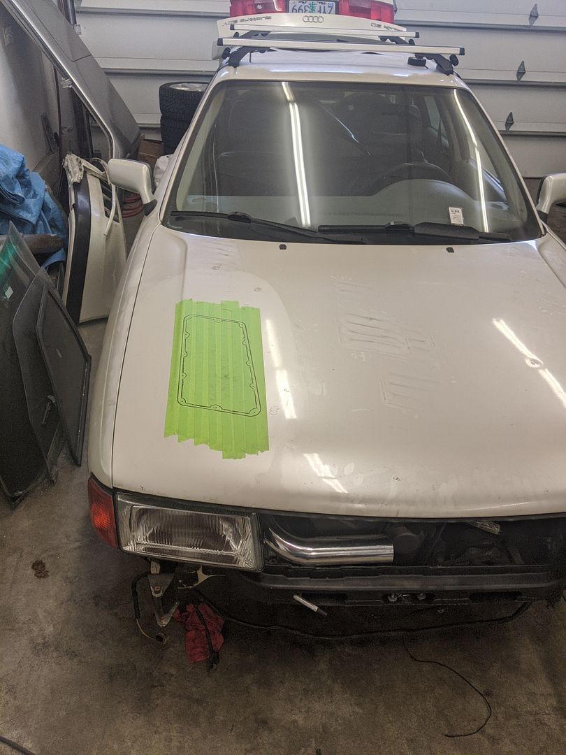

I think around this point I developed stockholm syndrome. I was temporarily working with a buddy(the allroad owner) as a parts guy at an audi dealership which was pretty fun. Real lax and I saw a lot of cool cars and crazy E36 M3 the germans design. Everything german is overbuilt, sometimes to the point of being debilitating. And the prices. Oh boy. Well, I found an old audi 90. Again, because old cars are just empirically better, right?

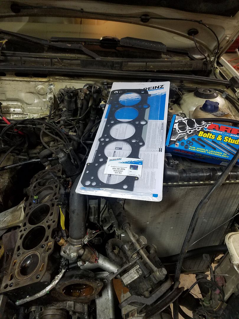

It had an engine swap already but the headgasket was popped. A car club buddy had built it and then sold it off and I picked it up after sitting in a field for well over a year. There were some questionable things done.
Of course I immediately threw parts at it like crazy.

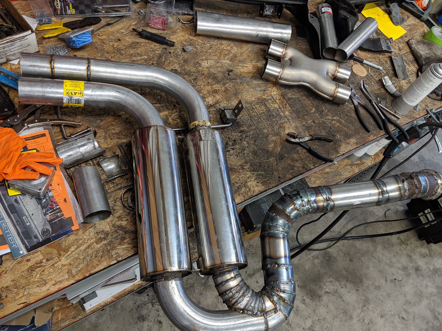

Built a funky exhaust from some spare parts.
Immediately my coworker decided he wanted the car. It's cool and fun but just not really me. It's not even in his name and he's already bought wheels/tires for it.

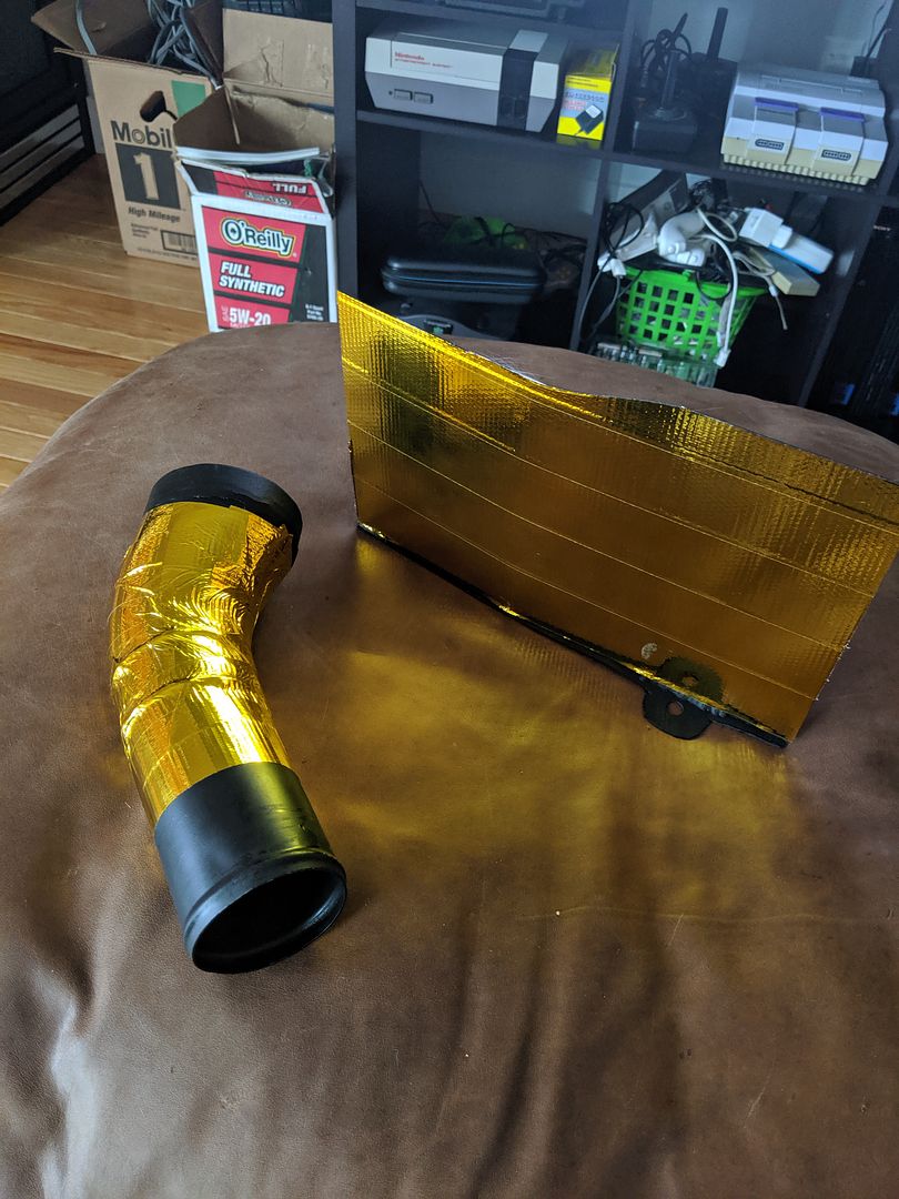

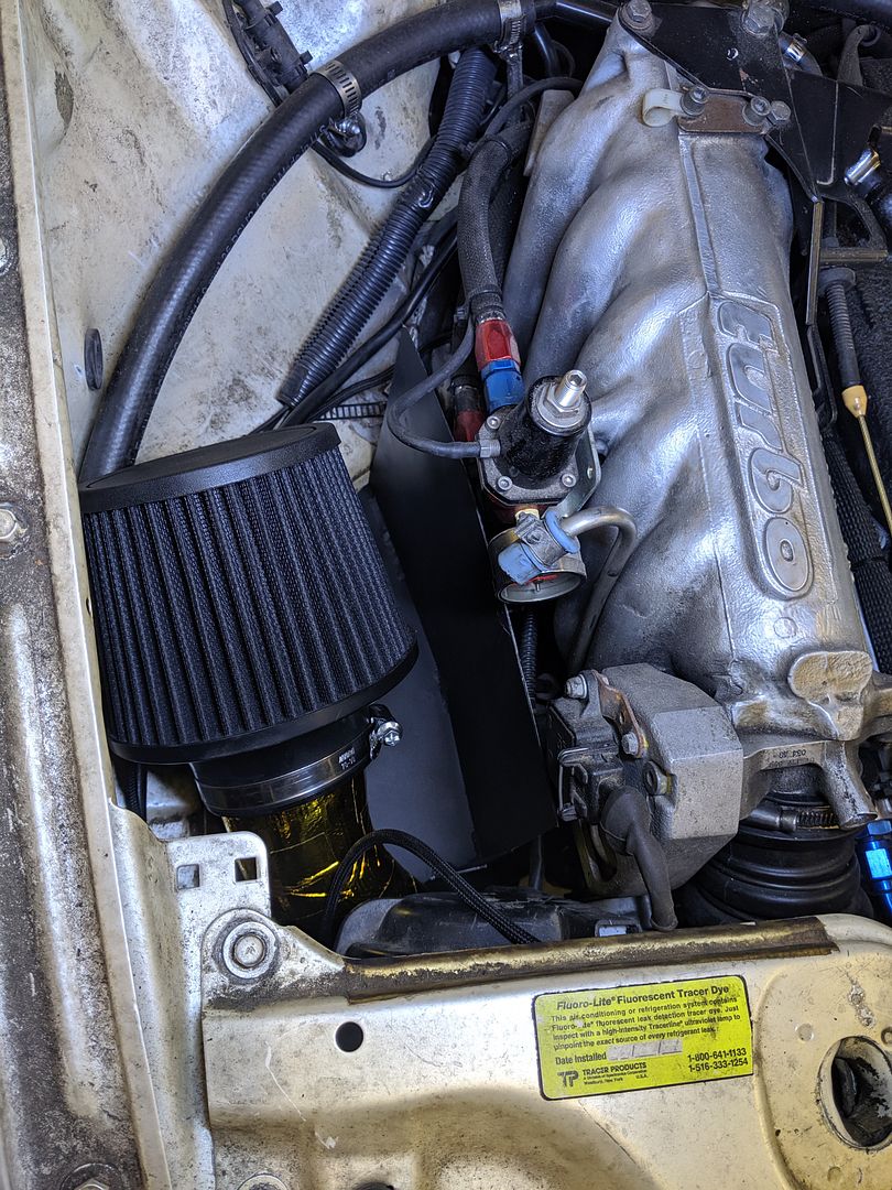

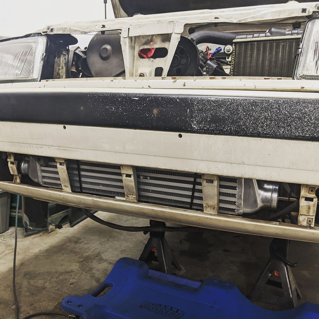

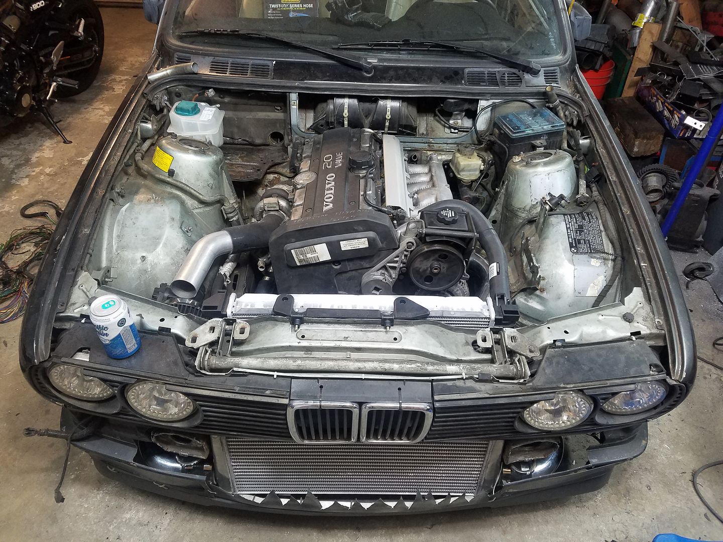

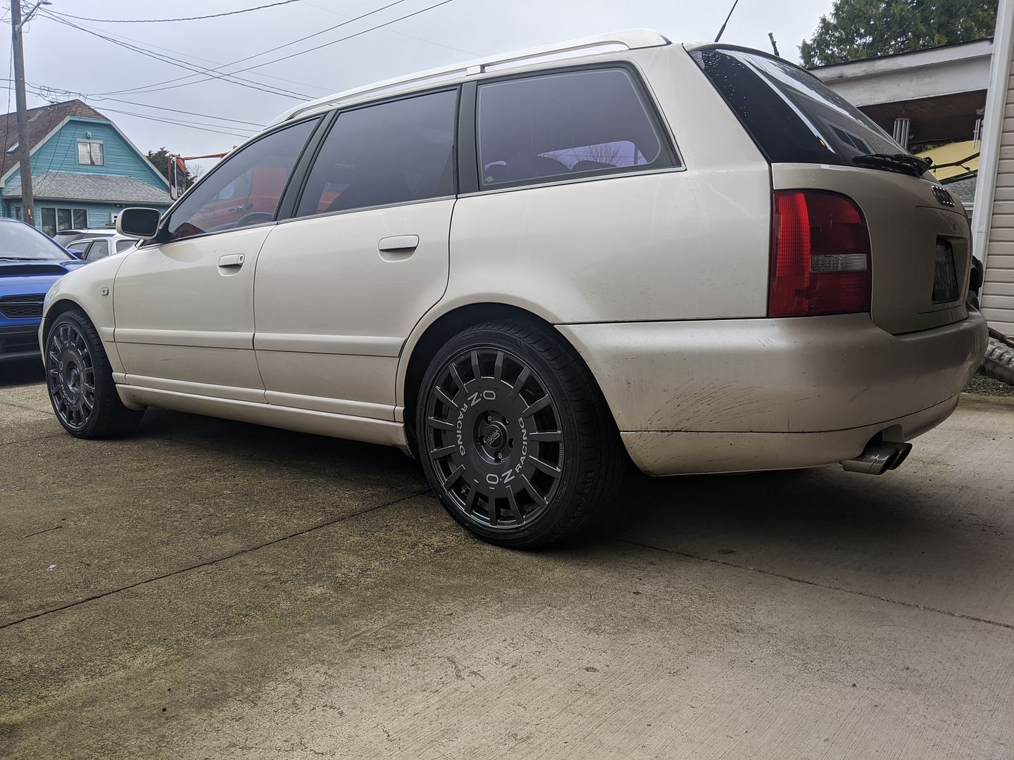

There were some problems with IAT temps. Since this old 5 cylinder wasn't a cross flow head design the exhaust manifold COOKS the intake and intake manifold. Then comes the heat shield, hood vent and intercooler. It's a racecar, afterall.
My coworker proposed trading this 90 for an s4 avant he had. I was down for that. I love wagons. I think I only have two picture of it so far. When I put the wheels on it, and when I upgraded the seats to newer s4 recaros.
It's an autotragic though. So I grabbed a 6speed from a coworker and will be doing that soon. That's above the v8e30 in the long list of cars to work on. My girlfriend tells me she hates that it's auto but she's commandeered it anyway. Evidently since the truck doesn't have a/c, the s4 is better for some reason. She'd think she's nobility or something.

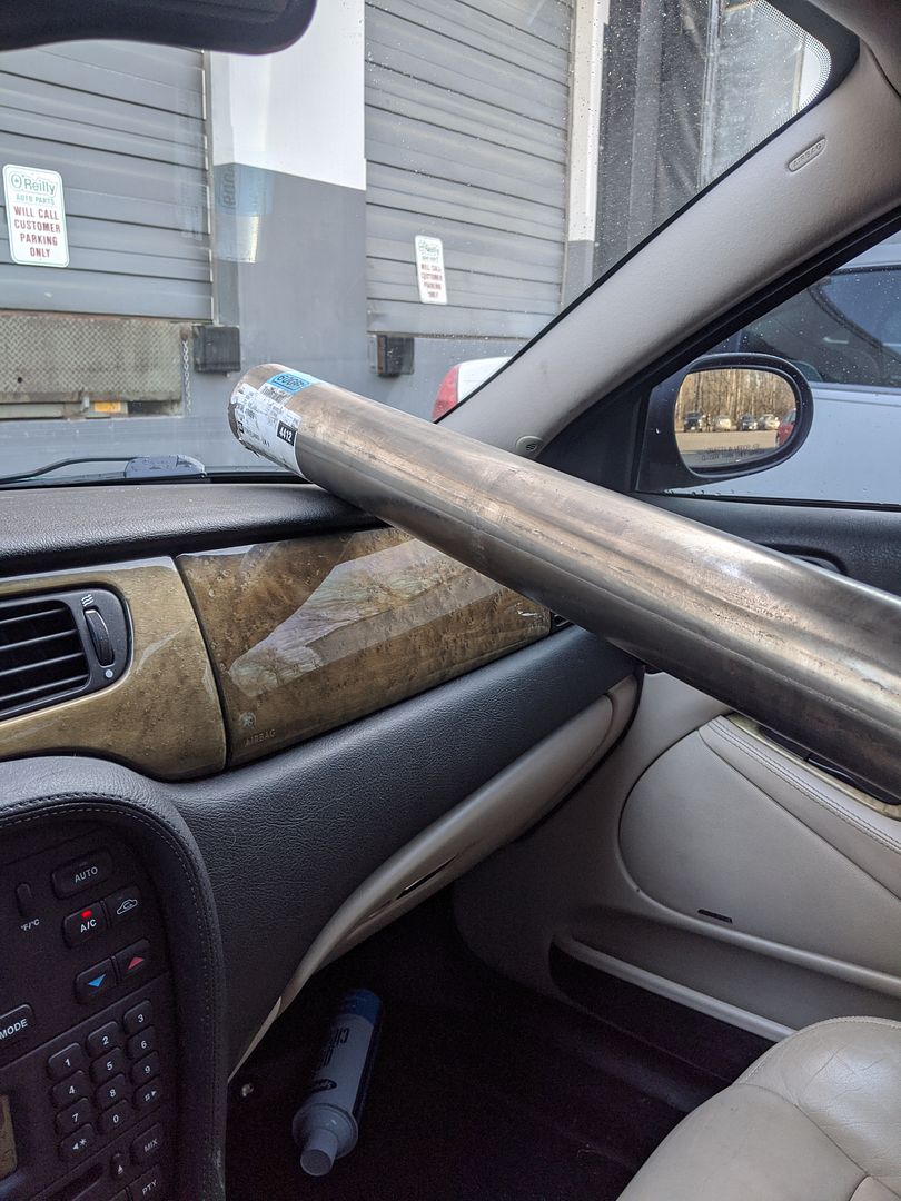

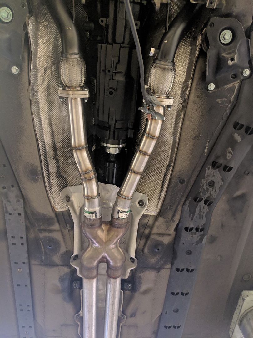

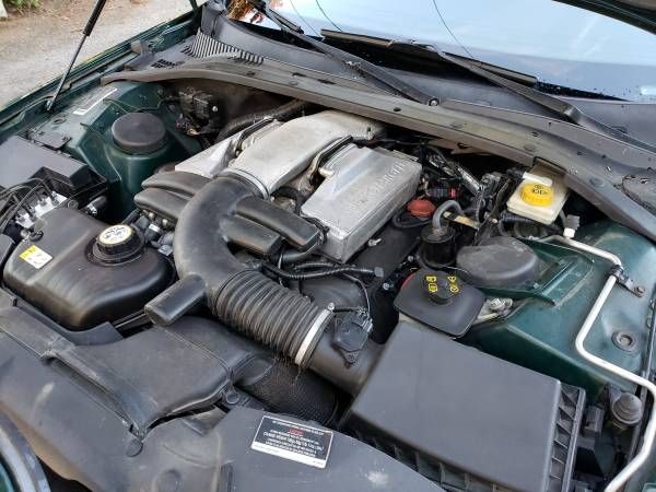

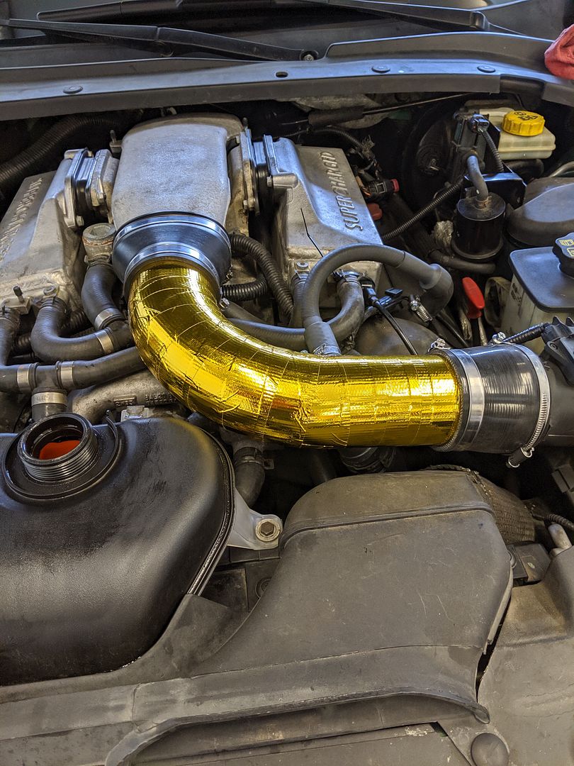

2003 Jag S-typeR. I always thought turbos were cooler than superchargers but damn, an eaton blown v8 gives a hell of a lot of smiles per mile. Especially in this big boat. This thing is well appointed for the time. Big 14" brembo brakes at all four corners, wide 245/275 tires, just under 400hp, plush leather interior and damn was this thing quiet.
It was stock when I got it with a few issues here and there. The heater didn't work, stereo didn't work and some misc trim pieces needed to be replaced. Turns out there is a secondary electric water pump that runs at low rpm that wasn't circulating coolant to the heater core. New relay fixed that. $45 junkyard radio and I had tunes. Then came some mods. Cut the mufflers off, added an intake and a pulley. The factory pulley was stuck so hard on there I had to cut it off!

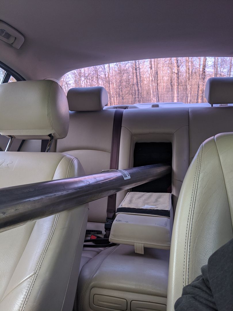

Incidentally, you can fit a 10' stick of 2.75 exhaust tubing if you open the skipass...

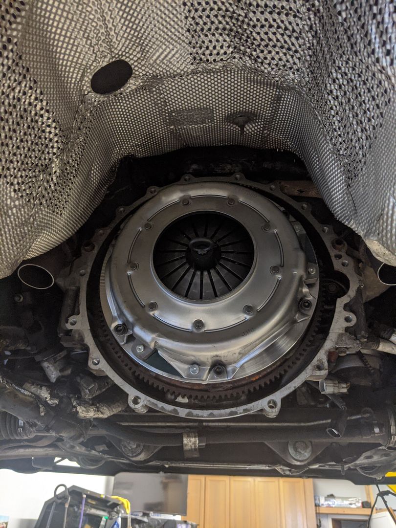

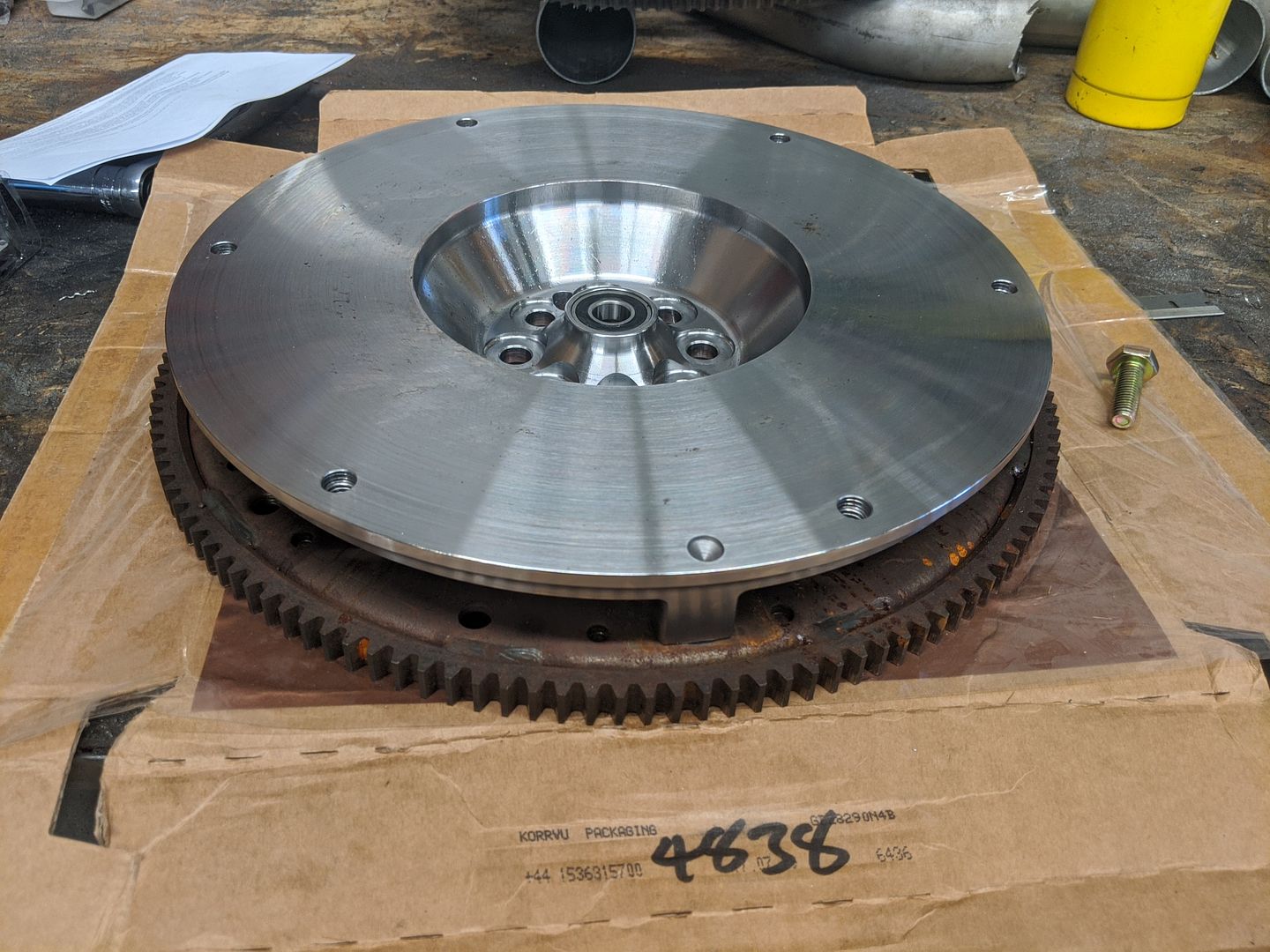

But again, I hate autotragics... This thing never came from the factory with a manual transmission like the M5 it was fighting against (and lost, obviously). However, the diesel stypes use a ZF box normally found in BMWs that has the same bolt pattern as the v8. Voila!

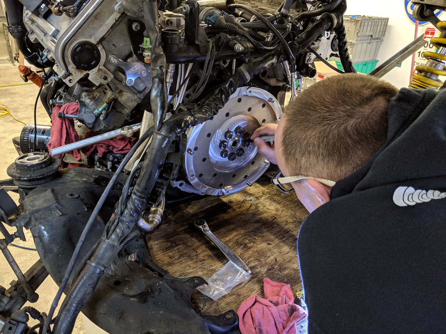

Factory flexplate, custom flywheel from europe and a standard GM 10.5" clutch set and I can bolt it all together!

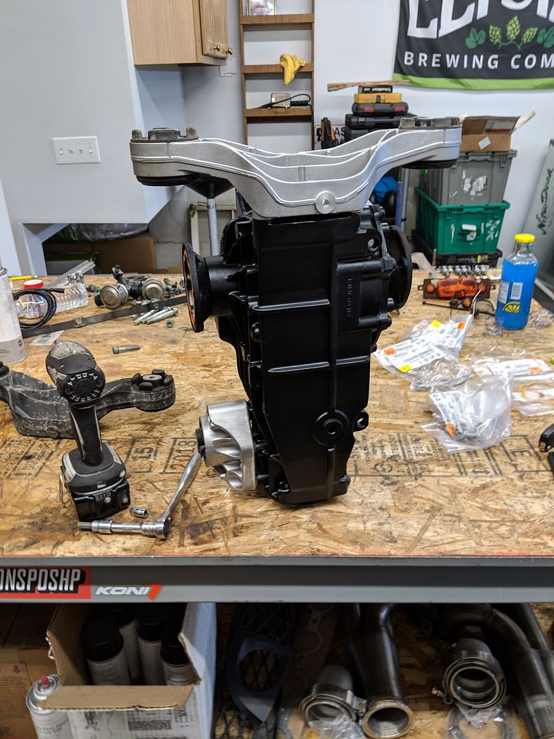

This is how the car sits right now on my rack. I mistakenly didn't look at the clutch slave cylinder before trying to hoist the trans up. It's boned. I'm waiting on a new slave (again, from europe) and then I can bolt it in. Looks like the trans mount is the same and the crossmember is mounted on sliding bolts. Driveshaft LOOKS the same but I won't know for sure until it's up.

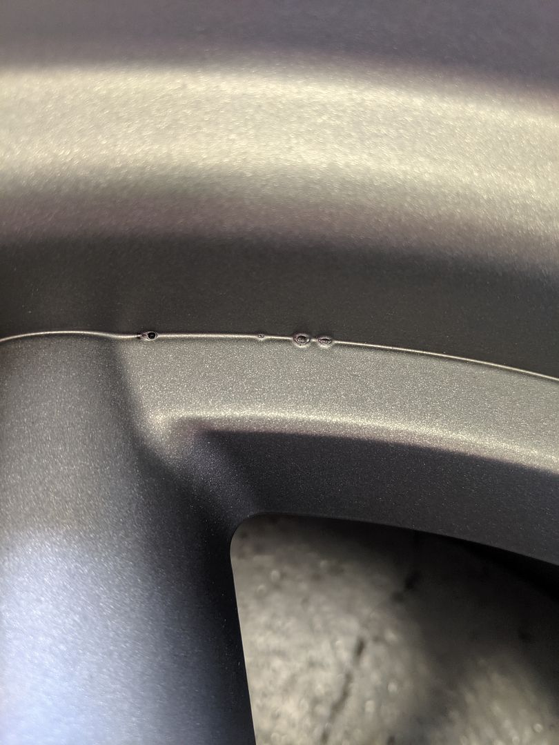

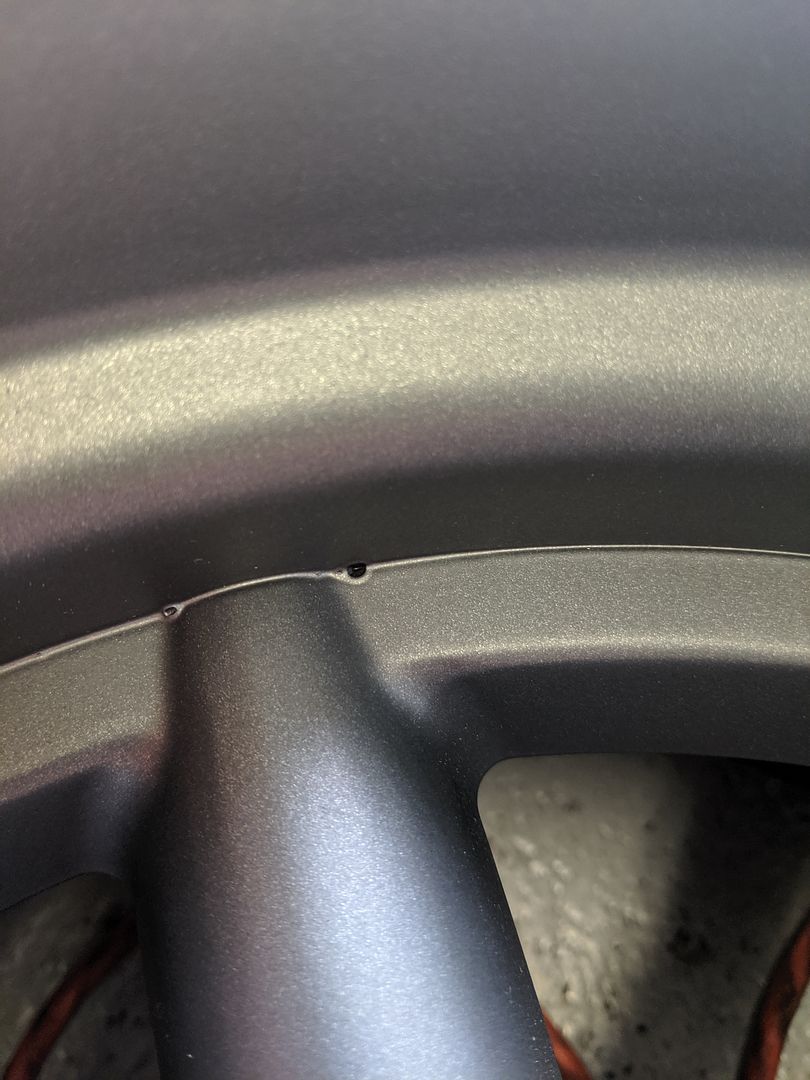

Oh man. That was a debacle. They are custom Rotiform MLW 17x9 2pc welded wheel. A bit over 2 years from when I ordered them, to when I could actually mount them on the car. Firstly, DO NOT order custom wheels from a company you're not familiar with. I got excited when Cedar Performance out of Tennessee spoke my language in regards to offset, wheel design and color. Well, that guy ghosted me multiple times. I ended up tracking down the rotiform rep that deals with cedar and had to communicate with him directly. First the wheels wouldn't clear my factory brakes. Which they didn't believe since "they've done tons of wheels for e30s". So they only fixed two, which means I can't rotate my square setup. That was one of the main reasons I went with a custom wheel, rotation ability Then, I realized that multiple wheels had bubbling in the powdercoat. Only one of them was severe enough that the bubbles popped so I sent that one back (because I was fed up at this point) and the shipped it back the wrong color. I'm done with rotiform. I absolutely love their wheels, but their customer service is absolute atrocious. I ran big white tire stickers on the Falkens I had previously and I ordered a 3 that say falken and one that says f*ck rotiform but I haven't put them on yet.

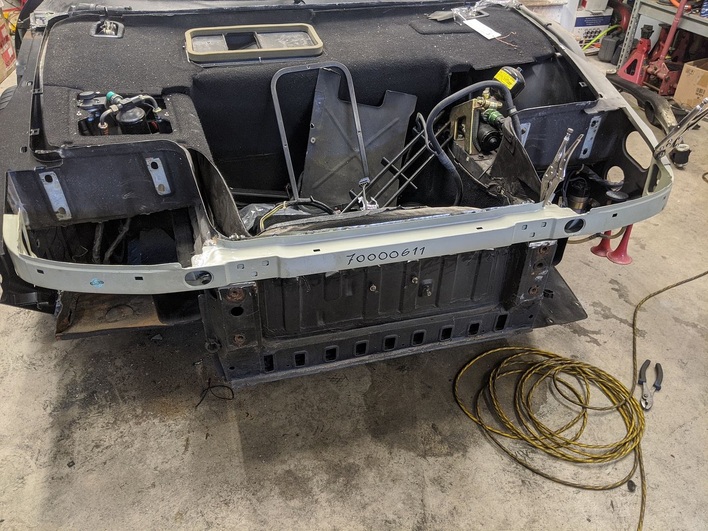

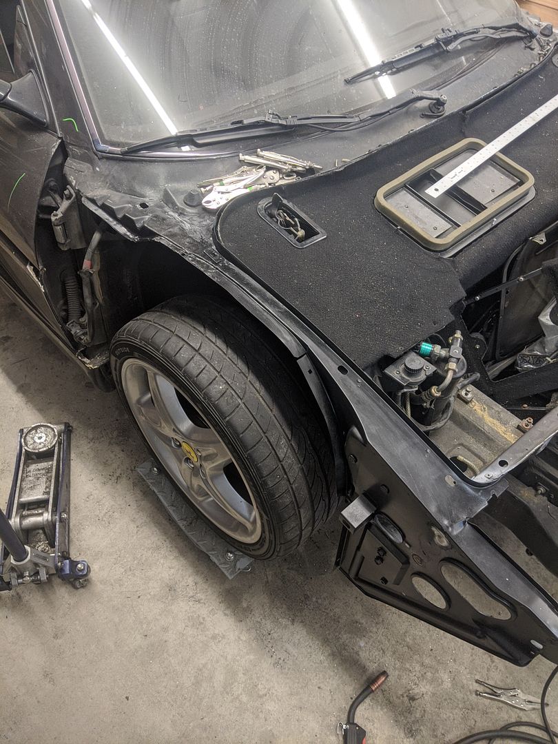

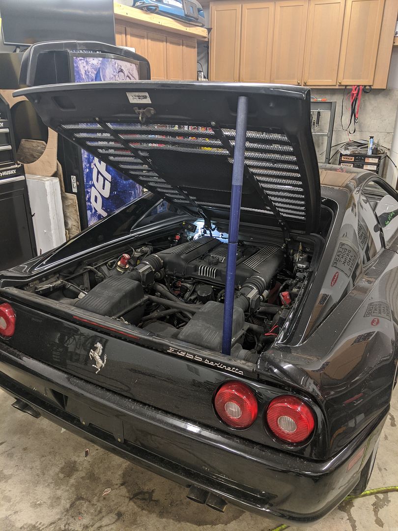

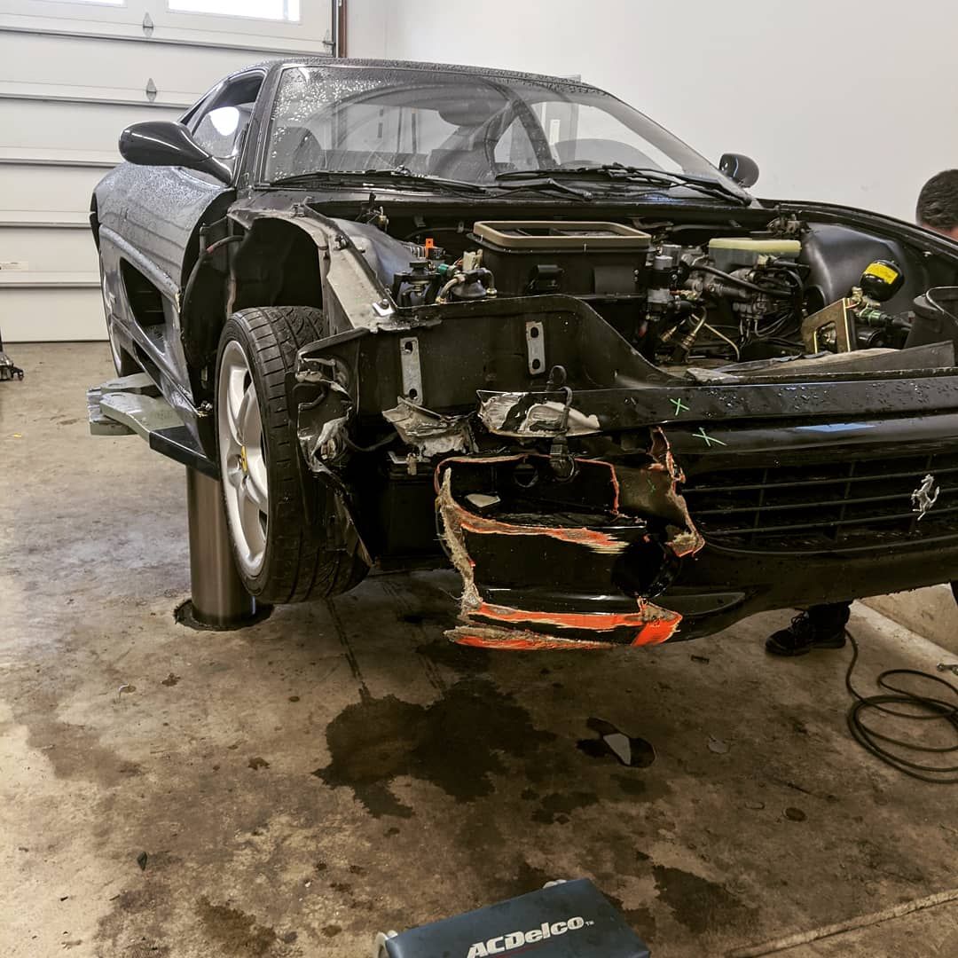

Along came a horse. A prancing horse. A long time friend picked up one of his dream cars while working high stress finance type junk and then quit. And then wrecked the car. Big sad face.
He made out like a bandit though. He got the car cheap, insurance payed over double his buy in. And that payed for parts to fix it! He towed it over to my place and we started picking it apart slowly.
I welded in a new front nose bar (is it a core support if the engine is in the back?) and passenger side fender support.
That front support piece is the last one in the world. He found a ferrari specific body shop somewhere in california that had one sitting on the shelf since it was NLA from ferrari.
Right now the whole front end is loose while we wait for some misc clips and a headlight bucket. Then we can bolt everything down for the body shop to paint. Unfortunately, he wanted to do the 30k service on the car. Which on this is an engine out affair that includes timing belt. Not a huge deal in and of itself but I did a compression test and found a low cylinder and a completely dead cylinder. Whomp whomp. He found a ferrari guy that'll rebuild both heads for around 5k. He's mulling that over. The temptation is real to throw a pair of small turbos and a standalone on it though... There's so much room back there!
