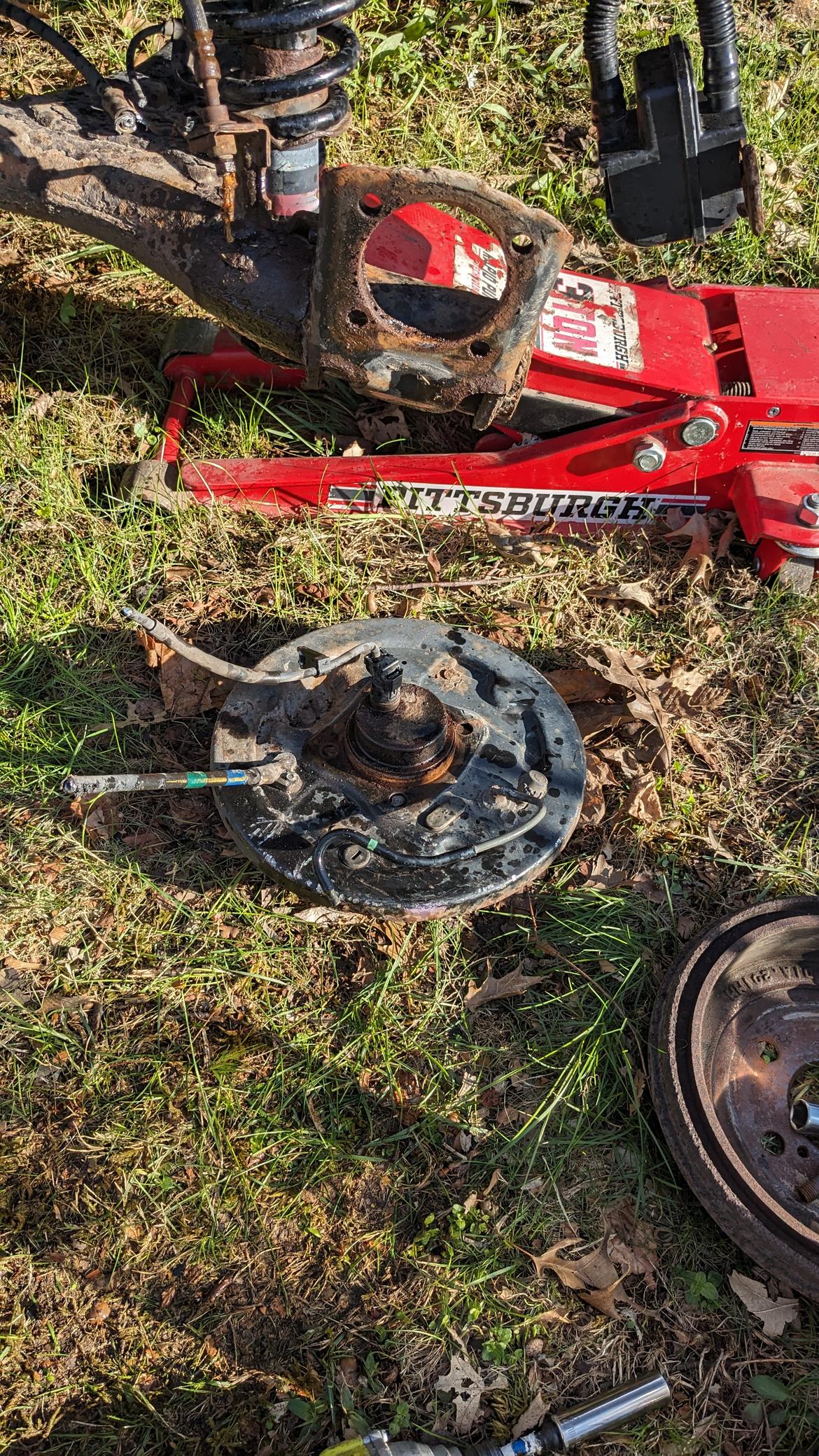

When new, there's not much "meat" on Prius rear shoes but those look to be down to the bone.
Prius rear shoes are cheap.  Since factory units last 200k miles, even super cheapo units should give you 50k miles which could be longer than you own the car.
Or, you possibly have a parts Prius.  Just bring over some used drums and shoes over from that car to this one.
