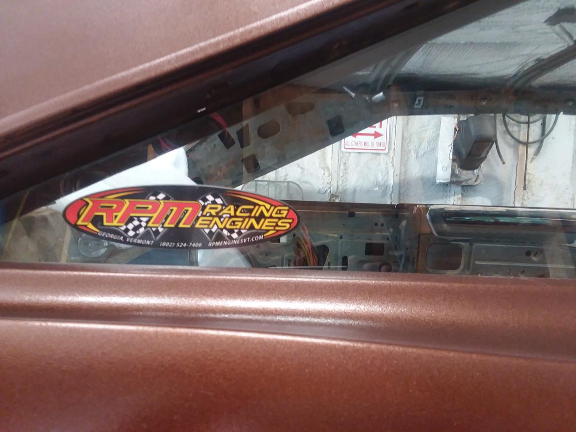

Hello again!  I'm Baaackkkkkk....lol.
Lost touch with this forum over the last year and a half.  In the interim i've gotten her painted and began reassembly. The motor is about to get dropped as soon as spring arrives in few weeks. I've gotten all the mounting bits sorted and got a load leveler for the hoist. I bought all of the door and windshield seals and the front and back glass are ready to go back in as soon as it's warm enough so I don't have to fight stiff rubber gaskets.
The tail lights are in place.
Here's the pics...

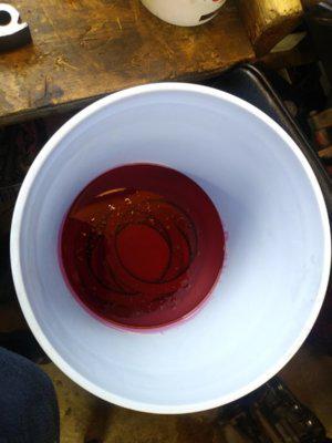

The process....
