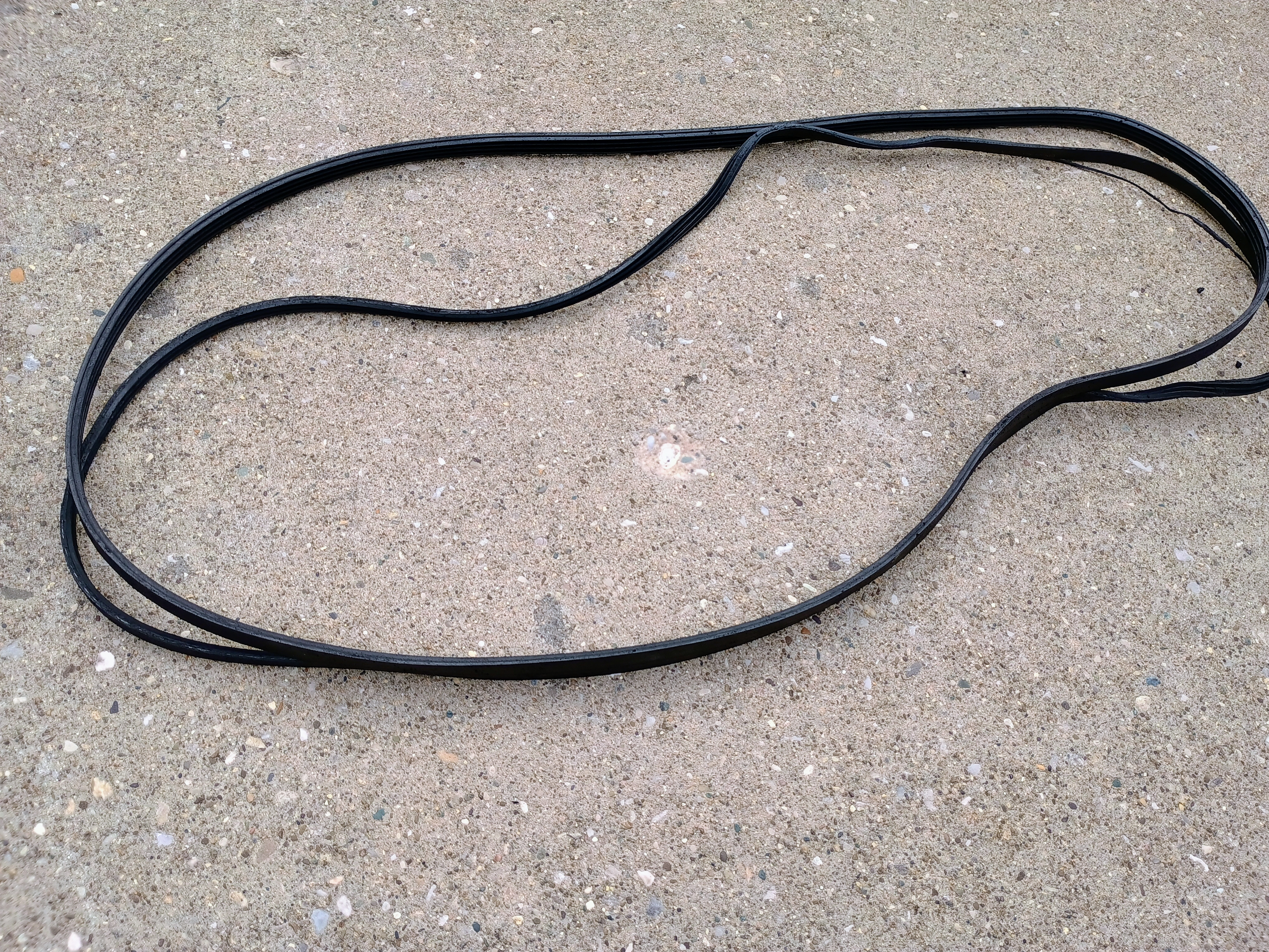

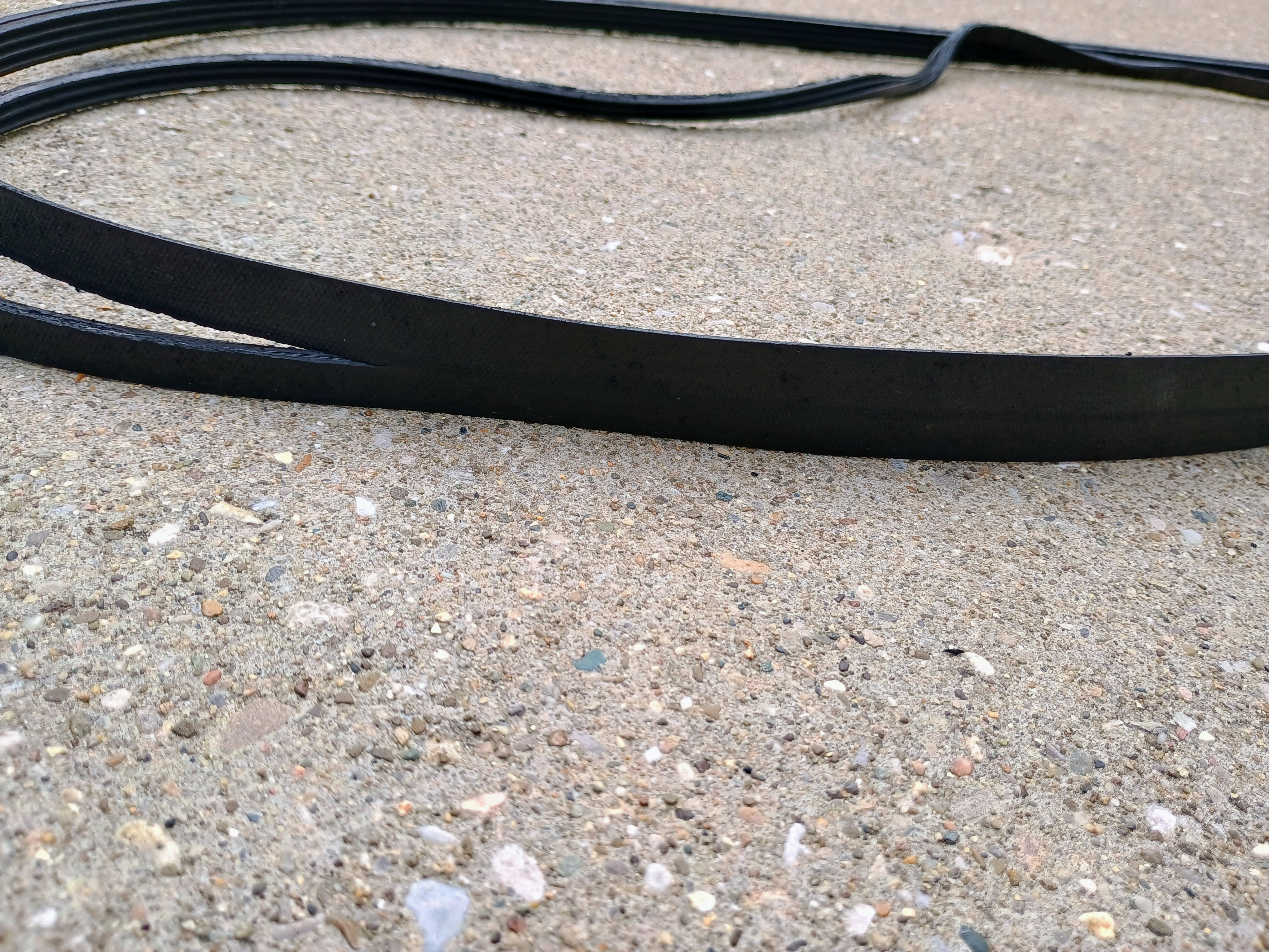

wae
wae UltimaDork
3/3/25 3:35 p.m.
Got the belt changed out this morning.  Interestingly, it didn't come all the way apart:
Looks like it basically came apart in the center and split.
3/3/25 3:39 p.m.
You got an Adam belt!
It's missing a rib...
