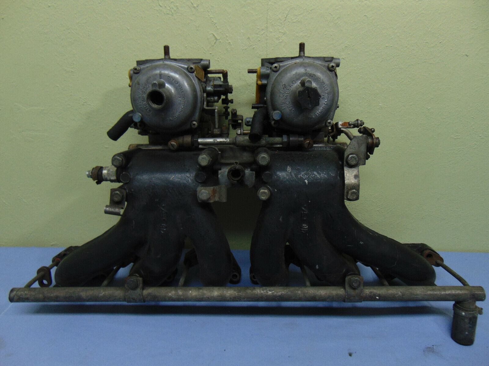

Example of ONE side of carbs needed: $399 on eBay.
Then you need the other side too, so  approx. $798 additional cash. You never include this cost in your "free" V12 build scenario so often promoted.

frenchyd
frenchyd PowerDork
7/17/20 3:20 p.m.
Snowdoggie said:
In reply to Indy "Nub" Guy :
Are old Strombergs worth big money now, or is that just for the intake?
A quick check shows Zenth Stromberg 175's selling for about $65 each on EBay.  The Carb manifold isn't that rare.  With more than 25,000 sold and the majority of those came here to America.
California alone accounts for more than 50% of Jaguar's production. But I know a lot of them have been reused in later cars. It was the common go to for those of us  who did not understand the fuel injections and didn't want the expense of Weber's.
Personally I swap the Zenth Strombergs for the HD 8 SU.  That's what Group 44 did  when they won the SCCA Championship with their XKE. V12
Huffaker used the Zenith Strombergs and made more power, but I'm just not that comfortable  with them.  Curto stocks parts for both in New York  as does Moss motors and others.

In reply to frenchyd :
My 79 MGB had a single Stromberg that looked just like that. My 74 MGB and just about every other British car I ever owned had twin SUs.
frenchyd
frenchyd PowerDork
7/17/20 3:28 p.m.
In reply to Snowdoggie :
I think it's the same basic carb but don't know about the needle.
If you're looking for a V12 carb set  there are several places to look. I keep stumbling across them periodically sometimes really cheap sometimes for scrap metal prices.  Never seen a High dollar set.

For those of us who don't have a left and right side Carb Intake Manifold for the V12 Jag, How are we going to get them?  At this point production numbers are irrelevant. It's not like XKE's are in the junk yards anymore.
eBay may be the only option.
