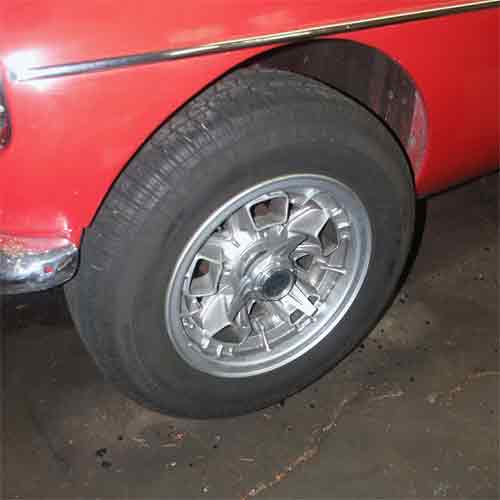

wspohn
wspohn HalfDork
8/12/17 12:48 p.m.
My Lamborghini also used the small splined hubs with magnesium wheels and had 100 bhp more than any Jaguar of the time - no wear issues. This is one of the Campagnolos I stuck on my MGC just to see if it had clearance (it didn't)
