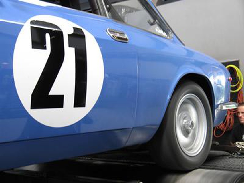

Our preparations for the Gold Cup continue! The ignition sensor for the dyno wasn’t functioning properly, but we did get a chance to track the air/fuel curves. The car appears to be running very rich. The ratio starts out at about 10.5:1 and rises slowly to 12.3:1 by redline. That’s a little odd, c…
