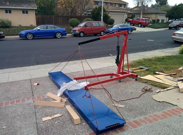

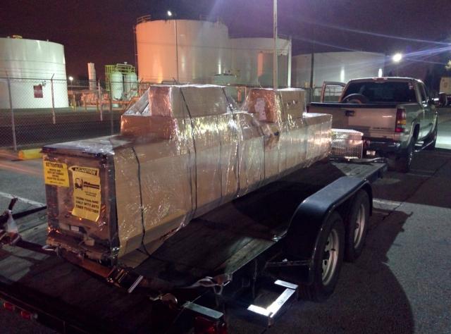

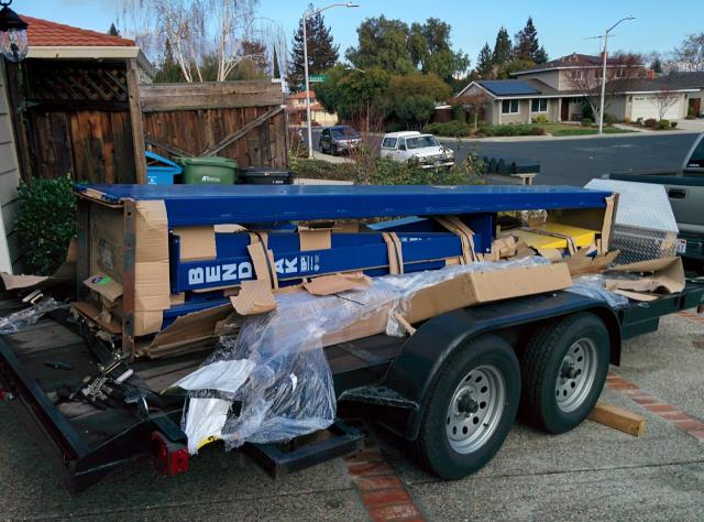

Installation is DIYable if you've access to an open trailer and a few friends.  They'll ship it to a freight depot, you can go pick it up there and they'll forklift it onto the trailer.  Strap it down, tow it home, then at your house you can take the package apart on the trailer and the individual pieces are more manageable.  Not single-person manageable, but with 3 or 4 guys it's not an issue.  An engine hoist is useful as well.

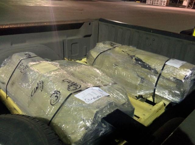

The RBJs came on a pallet that they put in the bed of the truck.

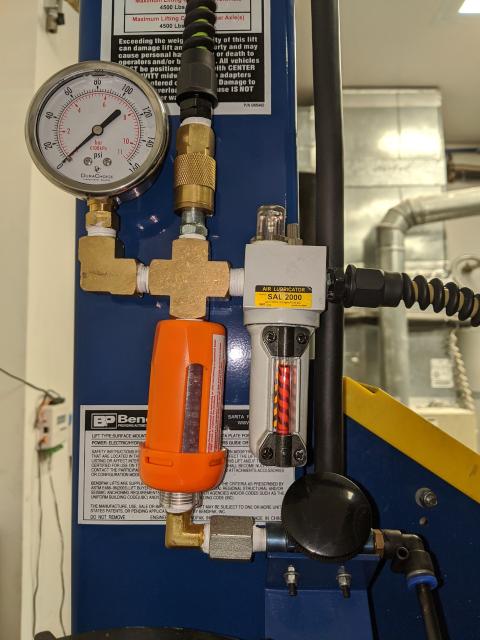

For accessories I have the two rolling bridge jacks, the air line kit for them, the removable aluminum ramps, a pair of drip trays, and the casters.  As I said I never used used the casters, and the drip trays are only somewhat useful with the RBJs because they sit on the same rails.  The RBJs are super useful, as is the air line kit for them (otherwise you need to hook up an air hose any time you want to use them).  The aluminum ramps are pretty much a requirement for my application because I don't have the space to leave them permanently attached and they weigh half of what the steel ones do.
I have the 220v motor for the pump, it's much much faster than the 120v motor that my friend has on the same lift.  I ran air lines around the garage to the lift, with a splitter to an inline-oiler for the bridge jacks (they need lubricated air) and a dessicant dryer for the safety catch release (they are dead-ended, so the air going to them needs to be as dry as possible).
