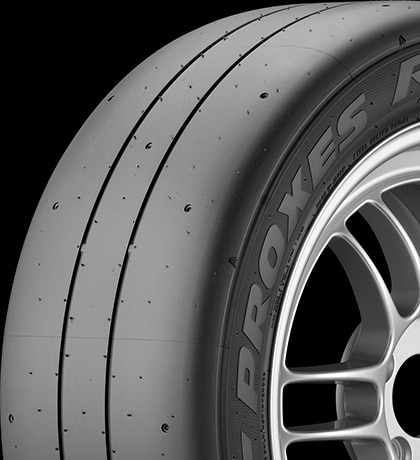

What about the "TW doesn't matter" tires? Unless I call Mr. Bergin and go with used Hohos, I'm looking at one choice that's within budget. And, frankly, the only other choise at any price is the Hoosier A7.
Proxes RR:
The Hankook Z214 used to come in 225/45/15, but it seems not to any more. I could go to 225/50 but I'd really rather not because I'm worried about how much fender work I would need to do. I could go up to 16s but 15s fit over the brakes and I'd rather not add the weight and expense if I don't have to.
I guess I could go with the Rival S, but I'd also rather not give up compound if I don't have to to meet class restrictions. Then again the RR is for road racing and I wonder how quickly a Miata can get heat into it during a 35-second pass.
1/28/16 9:27 a.m.
I run the RR on my car. Never tried autocrossing it, and my car doesn't have much trouble getting tires hot so it's not a good test. But it seems to come up to temp pretty quickly.

1/28/16 9:57 a.m.
Keith Tanner wrote: I run the RR on my car. Never tried autocrossing it, and my car doesn't have much trouble getting tires hot so it's not a good test. But it seems to come up to temp pretty quickly.
At $750 a set for new RRs, I'm leaning toward getting Hoosier A7 takeoffs. I can probably get 2 sets of past-prime A7s for $750.

I love RRs for track, but they're not the right tire for autocross. The tradeoffs are wrong -- they cost almost as much as Hoosiers, they really aren't any more streetable than Hoosiers, and they're slower because they don't heat up as quickly. If you're going to put up with the issues relating to those kinds of tires, just buy A7s.
1/29/16 2:14 p.m.
In reply to codrus:
I wasn't planning on streeting the RRs; I'll switch at the event. Hoosiers in that size are $250 each while the RRs are $185. However, I agree they are not made for autocross.
I actually just pulled the trigger on a set of 4 almost-new A7s from John Berget. They were 2015 Runoffs qualifying takeoffs. They're almost full depth and have a fresh mold date. They were about the cost of a pair of new RRs. So I think that will do.
