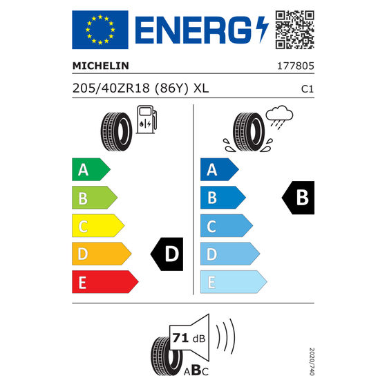

Yet another odd quirk of the North American tire vendors.
Go to any tire vendor website in the UK or Europe and all tires are rated in decibels.
But here that info is regarded as super secret for some reason. Seriously, try and find decibel ratings on tirerack or discount tire. It won't be there
I don't get it.
3/19/25 2:04 p.m.
The Euro tire ratings actually include a noise rating. You can look them up here: https://eprel.ec.europa.eu/screen/product/tyres
