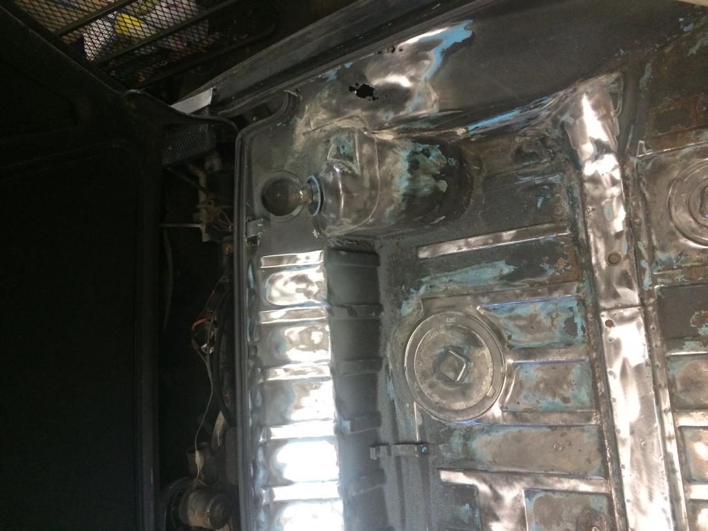

Cup wire wheel for your grinder. Make damn sure it is rated to spin that fast or use a drill.
It is what I used to do this:
