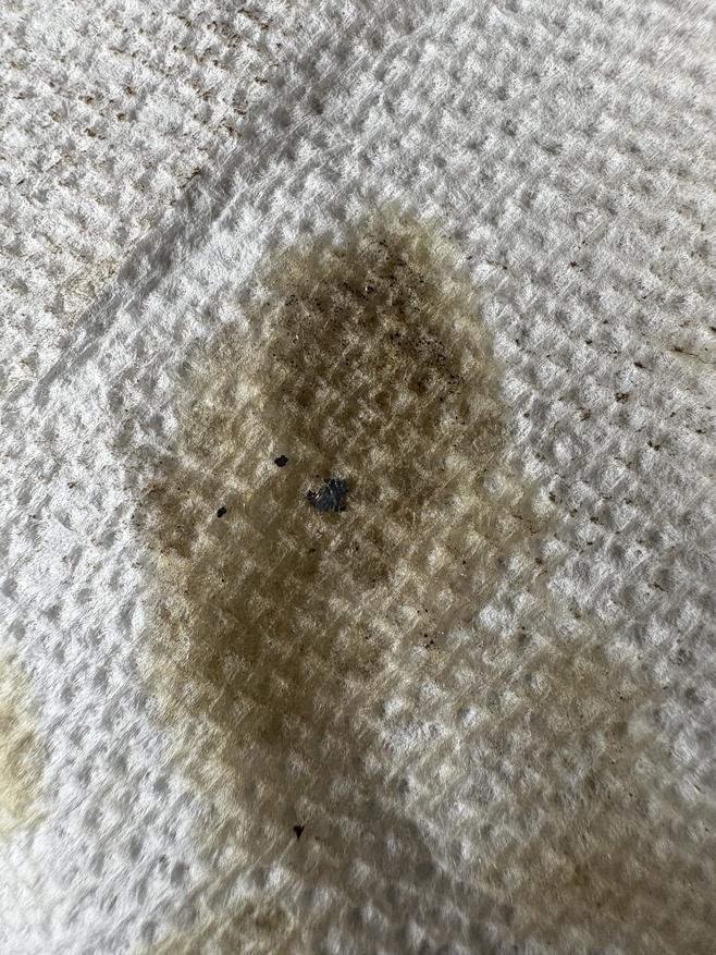

Which leads to the question. While the front sump was clean, there was some glitter in the rear sump
The video capture looks worse than what was wiped out, but there were a few non magnetic flakes

After 1-1.5 miles of driving with no oil pressure there has to be some bottom-end bearing damage. The good news is that with no oil flow the glitter would mostly fall into the pan and maybe get into the bottom-end passages a little. The heads might be OK but the engine will need disassembly, a block cleaning and a bottom-end rebuild (Edit: Other than rings, rings should be fine).

You've got the pan off.  Pull a few bearing caps and see what the bearings look like.  You could roll some new ones in if they're questionable.
I'm more concerned about where whatever locked the pump up ended up than I am the bearings though.

If the crank is clean or can be hand polished with some emory cloth I'd stuff in some new bearings and send it.
Either way, I'd definitely get the pan the rest of the way off and hose down the inside of the block with a few cans of brake clean. (Which reminds me, I need to get brake cleaner.)
