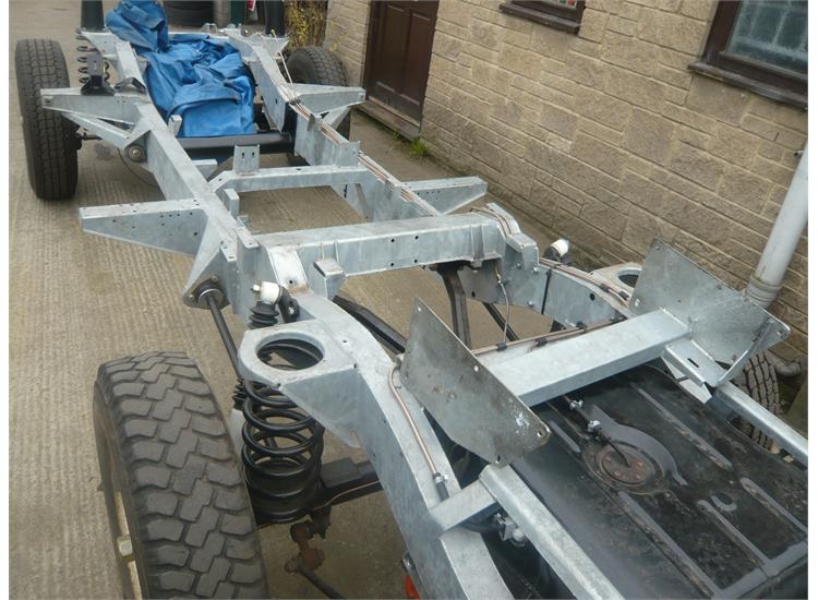

840 degrees.
dherr
dherr Reader
9/28/17 7:05 a.m.
That was my biggest concern as well. The zinc is at 850 degrees and after the frame is acid dipped, it is lowered into the vat of zinc for a few seconds, so the frame is going to get rapidly heated. The muscle car restorer crowd is not concerned as their frames are thick metal, but I wanted to see if anyone has done a Triumph frame and could not find any examples on Google.  Here is a Rover frame, but it is much more substantial than a Spitfire frame.
