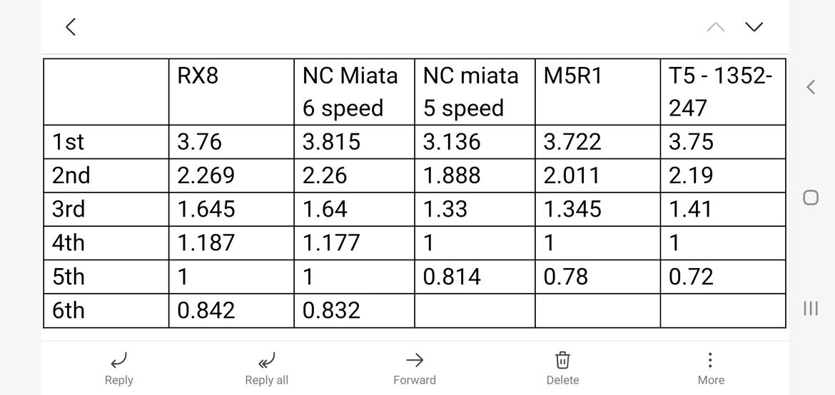

Here is a chart that I put together for various gearboxes and their ratios.
Edit: I am surprised at how close the Ford M5R1 and the GM tremec t5 are!

In reply to wvumtnbkr :
Just to be pedantic, the NC and RX8 ratios in your chart are both for early models. The late NC moved to a .787 6th, and the late RX8 used the same ratios as late NC but with a 1.536 3rd.
Everything I've seen on the M5ODR1 says that it's:
3.72
2.20
1.50
1.00
0.79
