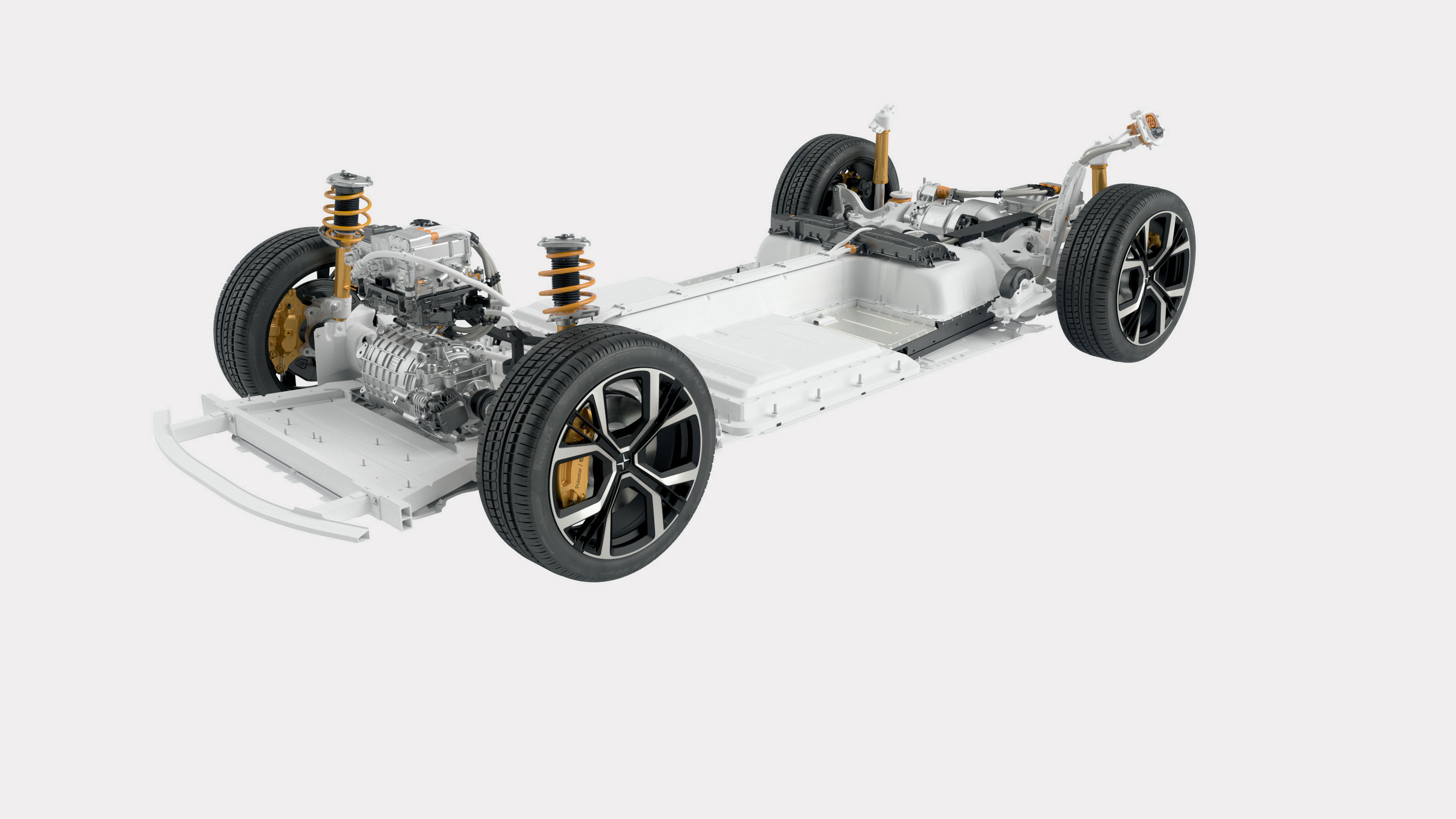

My latest bad idea is putting the body of a 67 Mustang fastback (likely fiberglass) over the chassis of a Polestar 2.  It turns out they have nearly identical wheelbase.  Performance should be ridiculous.  I had the idea that you could assess fit better if you superimpose renderings of one car one top of another, to see if "non-moveable" items like rockers and firewalls would be anywhere near close enough to make the project possible. I have done engine swaps and restorations, but nothing this ambitious.  Can anyone point me in the right direction to people with this ability? Thanks!. Tom

Yeah... Wheelbase is only one of the many measurements you have to compare/match/adjust for body swaps. Body width, track width, front and rear overhangs, seat cushion height, A/B/C/D pillar locations, drivetrain size vs. body envelope, overall tire diameter, to name a few. It is decidedly not as easy as it looks on YouTube. It is even harder if you want it to daily driver levels of refinement.

If wheelbase, track width, and overhangs are close, wheelbase positioning relative to the firewall is likely the biggest hurdle to overcome, second would be seat height relative to floorpan.
The first gen Mustang is a tiny TINY car compared to anything modern.
From looking at the two profiles, I am gonna file this under "leave it on the garage floor with the Busch Light cans"

The EV 'skateboard' layout is supposed to allow so much design and configuration flexibility.  Does it make post-production body swapping an EV any easier?
If you strip the Polestar down far enough, 'all' you need to worry about is fitting the Mustang body over the battery and the front struts.
The rest is just details... like getting all the Polestar electronics to work again (or replacing all the Polestar electronics with something else).

Most of the "Magic"  that comes with a chassis swap has to do with the firewall that comes attached to the new chassis. That is where the modern electronics, HVAC and controls reside. The less you mess with the firewall the better off you are.
Measure from the front axle to the middle of the front seats. Compare. 2" is about as far off as you want to be
Do the same center to center of the front seats. Same challenge 2" difference might be acceptable.
Measure the height of the dash. If the Polecat is too tall, it will look like your mustang is ridding on a plank. Mustangs are shallow and most early mustangs to late mustang chassis swaps do a poor job of getting over this discrepancy.
