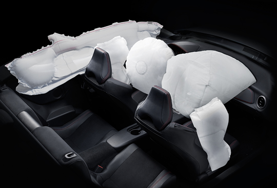

I've thought of replacing the seat with something aftermarket before. Does going aftermarket have any impact on the factory passive crash safety features like airbags, pre-tensioners, and so on? I ask because mine is mainly a street car, and I haven't examined what all is involved with these features, I just know there are more of them than my usual 80's/early-90's E36 M3boxes I've driven in the past.

If you use 3.3ohm resistor only thing it affects is not having a seat airbag, the SRS system will otherwise function as intended. There is curtain airbags from A pillar to C pillar plus steering wheel airbag.
I installed an aftermarket Recaro Sportster CS, there was a Japanese version (BRZ STi tS) that had the factory versions of the Recaro CS with airbags, both driver & passenger:
https://www.ft86club.com/forums/showpost.php?p=3318646&postcount=11
