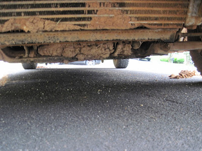

So what changes are good to make to a RallyX car? Skid plate? Mudflaps? LSD? Alignment? Power? Newer tires? I currently run an 1988 RX-7 in M2 class (Front is gutted). It already had Falken Azenis rally tires when I got it. It is not a street car.
Underside of car after last event.

moxnix wrote: I agree the RWD is more fun. I did my first event early this year in a SF saturn and got a M2 RX-7 for a very grassroots price soon after that for Rally-X. So what changes are good to make to a RallyX car? Skid plate? Mudflaps? LSD? Alignment? Power? Newer tires? I currently run an 1988 RX-7 in M2 class (Front is gutted). It already had Falken Azenis rally tires when I got it. It is not a street car. Underside of car after last event.
Skid plate, suspension and tires, but if you already have rally tires you are in good shape there. LSD would be good too.

NGTD wrote: Skid plate, suspension and tires, but if you already have rally tires you are in good shape there. LSD would be good too.
What type of suspension? Higher rates? lower rates? more travel? Longer springs? Do rally tires heat cycle out like R comps do?
Longer, lower rate springs with more travel, shocks to match. I am not sure if tires heat cycle.
