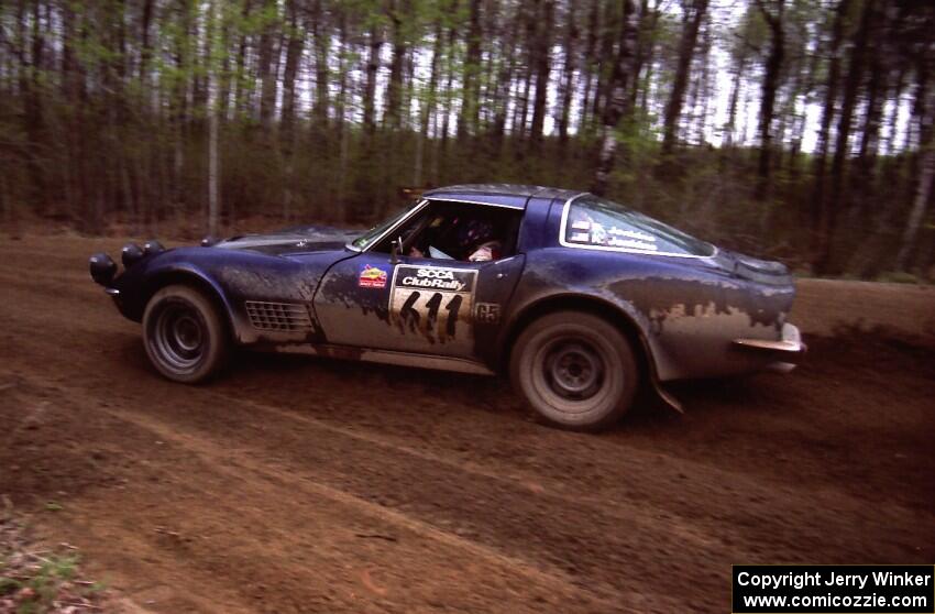

¯\_(ツ)_/¯ wrote: Inspirational picture:
I do believe I harassed that guy back in '03 or '04 when my brother and I went on a Hunter Thompson-esque trip down to South East Missouri to catch the 100 A/W.
The memories are sort of hazy but I do recall walking through Salem in a drunken stupor, taking pictures and talking to a few of the drivers when they were parked on the sides of the street waiting to be sent out to the start of the Rally.
I do remember being shocked that that car was an automatic.
I do believe I harassed that guy back in '03 or '04 when my brother and I went on a Hunter Thompson-esque trip down to South East Missouri to catch the 100 A/W. The memories are sort of hazy but I do recall walking through Salem in a drunken stupor, taking pictures and talking to a few of the drivers when they were parked on the sides of the street waiting to be sent out to the start of the Rally. I do remember being shocked that that car was an automatic.
That picture eased my mind about driving my C3 up one mile of dirt road to get to my house.
