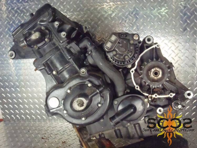

singleslammer
singleslammer SuperDork
8/11/14 10:44 a.m.
So a quick search puts the motor just as Adrian placed it. There may be some clearance issues with the output and chain at that angle but I am sure that I can make it a bit passenger mounted without too many issues.

singleslammer
8/11/14 11:46 a.m.
Small problem with passenger offset. There isn't much space between the coolant port and the shift lever. Looks like I might have to say screw you to balance and put it behind the driver.
