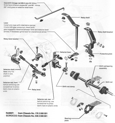

Talked a lady down to $100 on a 78 rabbit because it had a bad transmission. Stuck in 3rd. Handed her the money and she asked if I was going to call a tow. I said no and that I would try and drive it home. I actually waited until she went inside so she couldn't see me pop the front selector rod back into place
To be fair I did pay $4 for a new one later.
