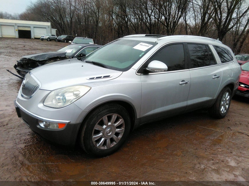

This one also has the same (or similar) engine:
https://www.iaai.com/VehicleDetail/39132440~US

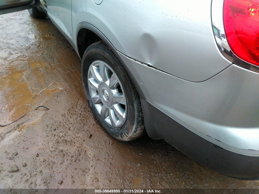

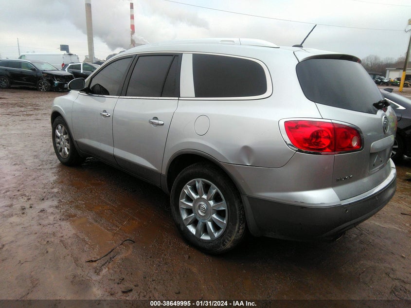

Enclave...if that rear quarter dent is the think that took it off the road, if I owned it, I would sell it without ever fixing it.  But 190k miles is a lot for this engine/trans combo.  Also note it doesn't have keys.  Your not gonna get to hear it run...more risk.  At the current price you'd have $1500 into it.  How much will keys cost?  If all goes well and you can have under $2k into it.  It might sell for $5k, max.
EDIT: MAKE NOTE...after really zooming pictures, the rear driver's side tire is twerked. Rear suspension damage.
Yeah, transmissions weren't terrible great on these. Also, these tend to turn into electrical nightmares before they even get that old.
My honest opinion; Avoid both of these. Neither seems like that great a deal.

In reply to John Welsh :
Good catch on the tweaked rear wheel.  I hadn't noticed that.
