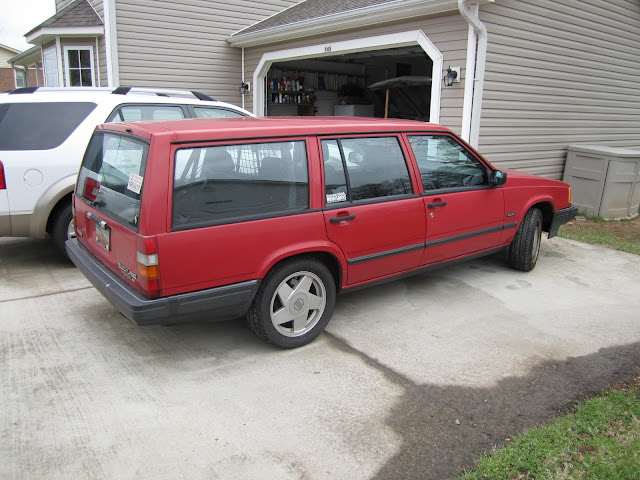

so we're getting a new family hauler next week... '91 volvo 945ti...
with all that glass and a black interior living in FL = not so good in my experience...
the last volvo wagon we had had "limo tint" (not sure of % its what was on when I got it) which was a love hate relationship... it looked GOOD... and during the hot summer it was great even without a/c... crack windows and the sunroof and roll along fairly comfortably... but at night it was hard to see out of... required cracking windows at intersections to get a good view of traffic...
so this is a multi part question... how dark should I go? I know legal is 28% for front side windows and 15%...
2nd... I want good stuff... I've seen what good tint looks like after a few years and I've seen what crap tint looks like after 5 years... what brand would be recommended... I want to say both my shelby charger and the volvo I had used llumar tint... the old volvo still looks good after sitting out in the sun for 6 or 7 years
and lastly... is this something I could do myself?... i recall reading DIY threads but can't see to find them...
this is a car I plan on owning for a good long time... so i'm willing to splurge for stuff that will last... but if I could DIY with good tint and have it look good the $$$ saved on labor would be nice.
thanks again guys mark

Well for starters, I personally think you oughta pay the guy you bought it from double (at least) what you paid.
Now that the self serving part is over, I agree. It's something I had wanted to do, as did JD. It does have the nifty 'crotch vent' though, which helps the driver tremendously.
Tint first, then a really good exhaust system. After that put a bigger intercooler and crank the boost and run 13s. With the family in it.
-Brian

Mark, I forgot to ask you. You can see a :: aheam :: politically motivated bumper sticker there in the pic - I can remove it if you're not interested in telling people how "you" voted in the 2008 election. I also have to send JD back his vanity front plate. Hope you don't mind.
