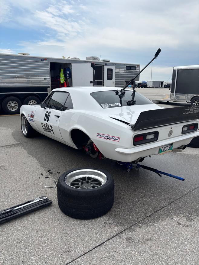

We just got back from running the Pro and Tour on the Vitours and I'm very happy with them. It was a first time at Lincoln for the car and first time for us on the Vitours. Using temps across the tread and looking at rollover on the tire edges, we landed up at 27 psi hot on our car but experienced some understeer, which was fixed by running 32 psi in the rears. Yes, I know we need stiffer springs in the rear.  Placed mid-pack in the Pro (mostly due to spins on the right side) but did beat the guy who won on the left side. I won the Tour and my wife came in 3rd but that was mostly due to us doing well in the rain on day 2 on Michelins but day 1 was cool but dry and the Vitours felt great once we got the shocks dialed in. I'm sure we could have finished in a similar order even without the rain-assist if we would have had the shocks sorted going into day 1.

loosecannon said:
...experienced some understeer, which was fixed by running 32 psi in the rears. Yes, I know we need stiffer springs in the rear.
Or some rake.
Might be a bad pic, but sure looks like the rear sits well below the front.  Looks like negative rake to me.  Simple fix and easy to adjust at events.
