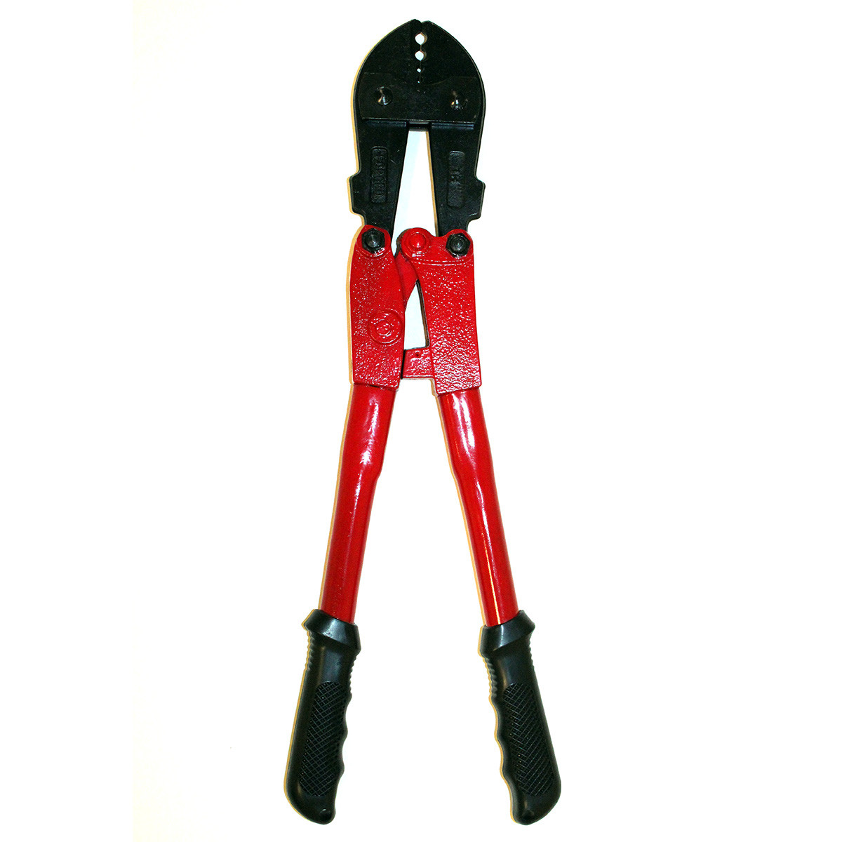

Find a local theater, hydraulic fab shop, or other industrial type place and ask to use their swaging tool.
It takes a ferrule much like the one you show and presses it on aircraft cable.  The ferrules are typically something ductile like copper or aluminum, so you'll want to back it with a steel washer, otherwise the repeated use will just chew the soft metal.  A properly crimped "neko" or ferrule will be stronger than the cable it's crimped to.  The type of ferrule you're looking for is usually called a "wire rope stop."  Once it is properly pressed on, it forces the ductile metal into the strands of the cable.  One of the demonstrations I give at the theater is to install a copper stop on a cable, then use the band saw to cut it in half.  You'll see that there are no voids.  In between each strand of the steel rope is solid copper.  Very strong.
If I weren't fuloughed from the theater, I'd tell you to send it to me and I would do it.  It costs me about 4 cents.
The tool looks like this:
and the stop looks like this:

I've never used that style, so I can't really comment.  The only ones I have used were like the ones I pictured above.  This one is $44 on walmart.com
The key to using a swaging tool is to get at least 80% of the ferrule compressed.  With smaller ones that might mean two crimps, but bigger (like 3/16" or 1/4") might mean 4 or 5.  Always start in the center and work your way out (or one end to the other) so the trapped air has somewhere to go.
