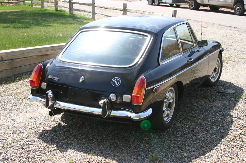

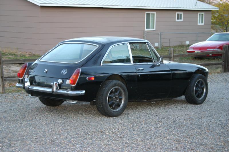

MrJoshua wrote: In reply to Keith: Old cars tucked their wheels waaaay into the wheelwells. The more modern look of a wheel that is flush (or hellaflush ) with the outside of the car would allow Miata suspension to work with almost normal classic car proportions.
As a guy who has just put a Miata suspension under an older car - it's not quite that easy The fenders tended to encapsulate the wheel, and if you push it outboard by 4" then you put the wheel right into the fender itself. See the D-type below. So you have to reshape the arches, and that can have a major effect on the look of the car. It's definitely a challenge, and I think the way you handle this sort of detail can make or break a kit. Note the fender flares on the Sebring A-H replica. Also, note that the wheels on the A-H 100 above appear to be nicely flush.
Another example. MGB GT on stock axles with SAAB wheels. In this case, the car is actually jacked up in the rear.
Same car, proper ride height. The SAAB wheels actually tuck under a bit more than stock.
Same car on Miata suspension, widening the track by 4". You can see what had to be done to the fenders in order to allow for full suspension movement. The ride height is the same as the previous picture.
